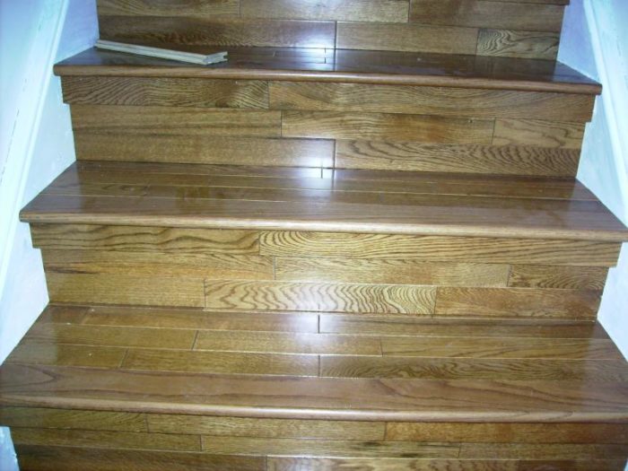

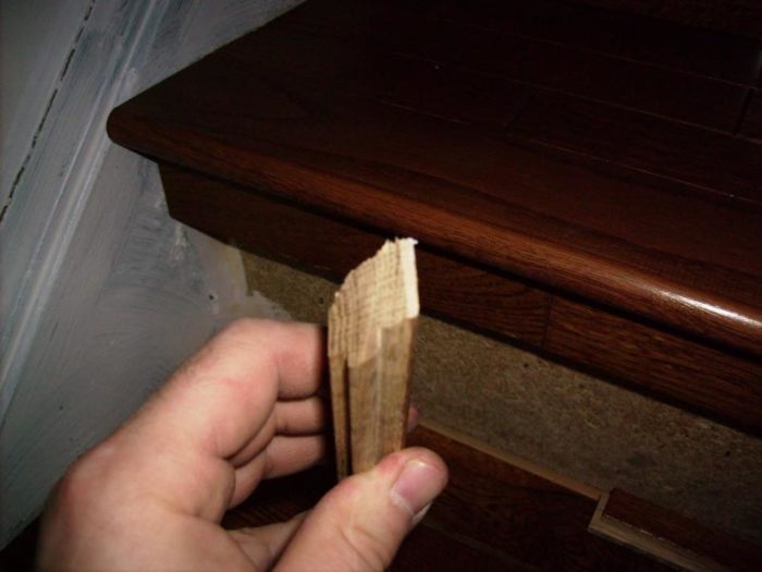

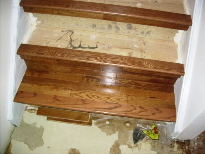

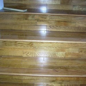

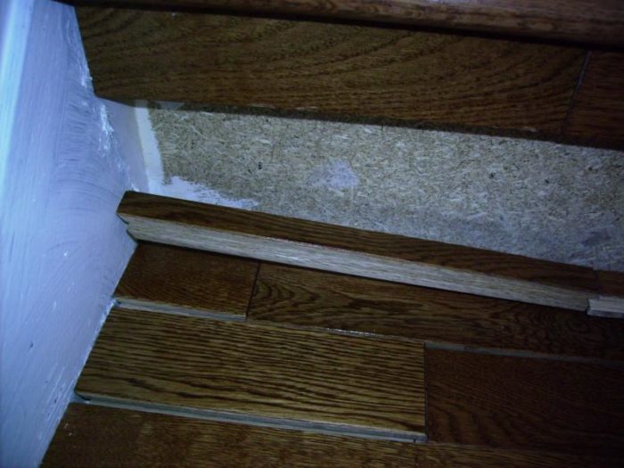

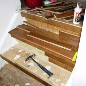

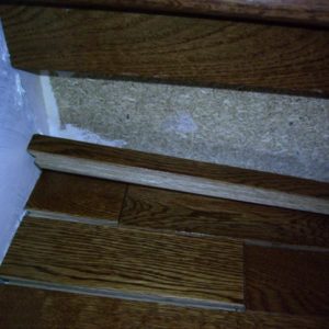

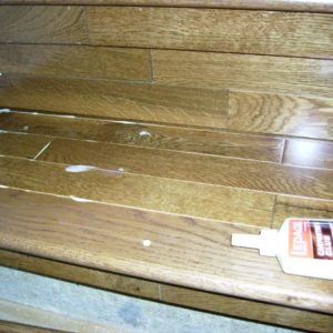

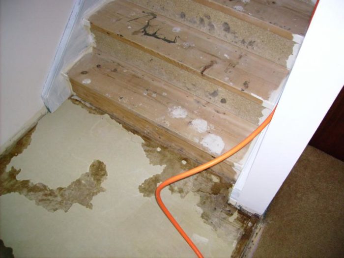

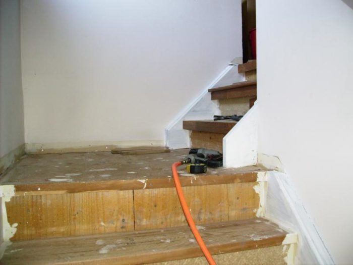

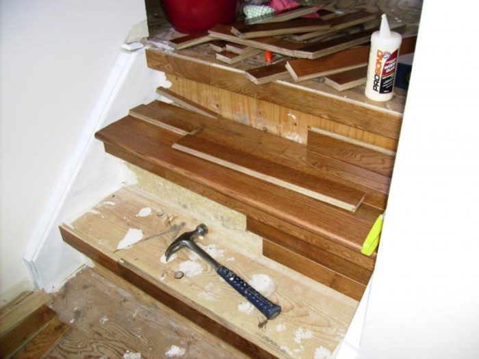

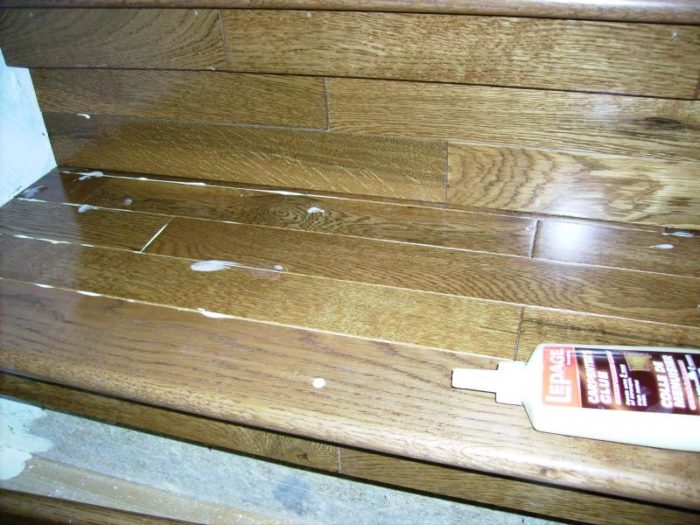

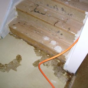

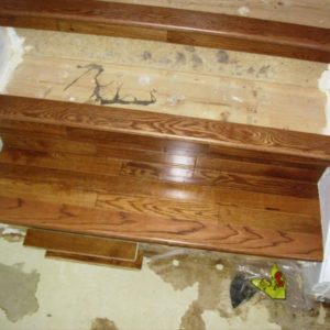

Got a job to do hardwood flooring,,,started with the stairs. I have been gluing all of the tongues and grooves together and then using PL to stick em down to the stairframing. I ‘m hoping that it won’t crack or whatever. I haven’t used any nails yet. The flooring is surprisingly high quality (perfect milling, perfect finish, straight boards) but the planks seem to be fairly short. The flooring is made in china.

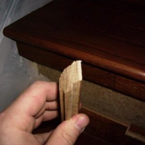

In some of the pictures you can see where i’ve back-cut the flooring in order to be easier able to tune it up with a plane…also backcutting helps it slide in better.
