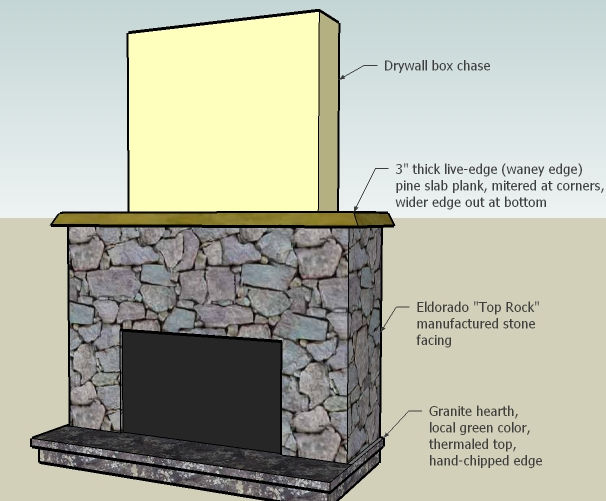

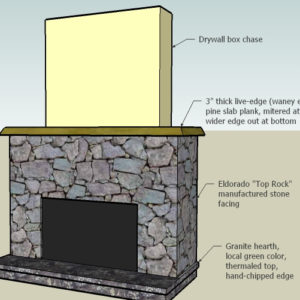

This is done, paid for, over. Client and their decorator signed off and wrote checks.
But it looked awful to me. The mantleboard is what I am talking about.
What would you do to improve it? There was no question about the material. It had to be rustic, pine, slab, waney edge (live edge) outboard.
The stone textures are just there to give you an idea. I don’t have seamless textures for SU to closely match the cultured stone and granite.
Maybe pine boards covering the drywall box above.
Did they have a plan for the big blank space above the mantle?
I'da flipped it over, wide edge on the topside.

and make it overhang more, at least in the front, but probably the sides as wellI wish I didn't know now, what I didn't know then
also yep. maybe the bottom (short) edge of the flipped mantle where the wide edge appears to be in the pic.
yep.
the problem lies in the chase above.
If the stone work and mantle is rugged applalachian style, use pine T&G or roughr. If it is nice marble and polished mantle, use painted raise d panel detailing
The chase is what's killing it. It looks too weak. Need to take the stone up to the ceiling. Also, that mantle board has to be flipped, so the widest portion is on top...
Gene, I'm guessing from the live edge detail that the slope wasn't too pronounced. I sort of like that idea... and might have played with sloping the chase in the same direction.I did this for a hot German fraulein, who insisted she only wanted 2" of shelf... "just enough to sit a pinecone"She loves it, but never did get a pine cone. Now you see this one-eyed midget

Another vote for taking the stone up to the ceiling.
Not sure about the shape of the chase, seams to look
"Framed" in to me.
I shoulda said . . . the chase was there.
All that happened here was that some crappy tile facing got ripped off the hearth and its apron, then the wood substrate structure for the hearth got ripped out and replaced with lower so we could do the granite without coming up into the fireplace opening.
Where there is stone, there is crappy ceramic tile under. It got Durock'd over, then the phony stone.
No one asked for anything over the drywall chase, which was there before, and still is.
The word was from the start, hey, this is a budget job. This, from a client that just spent $8MM or so on a little piece on the water nearby that has among other things inside, eight steam showers.
I was simply not pleased with the mantleboard, which looked all wrong to me. No one specified which way the waney edge was to tilt. It just happened.

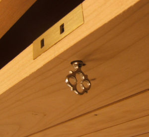

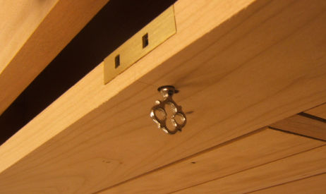

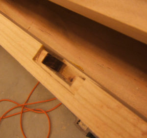

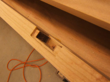

Recent work? Just today, I am getting near the end of a little cherry piece I'm making for my grandson. It's a treasure chest, and has a little English-made half mortise lock. Here is the keyhole, which will get plated with a small brass escutcheon. Cut with a drill, detailed with a coping saw and a file.
Here is the lock mortise, and the following pic shows the key going in from the face side.

I'm agreeing with you and duanne that the mantle edge should flip but not enough to change it now that it's one. Maybe I'd change my mind with a real photo to see the actuall as built.I liked snorts picture of FP with the tapering shroud chase above that neo-Rumsford.
>I liked snorts picture of FP with the tapering shroud chase above that neo-Rumsford.<
I agree. I think it's the simplest answer drawing attetnion away from the mantle. The tapered box could be raised panel, copper with decorative stamps or even a rough finish/tooled plaster. Right now it looks like 2 boxes stacked on top of each other.
Good eye, that was built to a Rumsford throat... but I was there when the masons set it, and I'm not sure I'd build a fire in it<G> Now you see this one-eyed midget

Good eye, that was built to a Rumsford throat... Do you mean the precast tiles?PS It looks like someone already had a fire in it.
Pre-cast throat... that's just black paint. Now you see this one-eyed midget

Cover the drywall with metal--either rusty steel or oxidized copper (or maybe a sort of antiqued bronze look).
There's nothing wrong with that display that a moose head can't fix.
Something like this one?

in my minds eye i see an old heart pine resawn beam maybe 4-6" thick and however wide... that says this is the place at which you stop looking and i need the stone to hold me up...... so you really wouldn't notice the chase... just think it needs the "beef" what you show is too wimpy imho
p
I'm with the others that think the chase above the mantel is the problem. Too much visual weight and interest below, then nothing up top for balance.
Since the look is rustic with the live edge on the mantel, I'd stay with T&G pine or maple above. Maybe you could use some of the prefinished wide plank flooring materials available. Board & batten cedar would be a good option, too, or a traditional panelled treatment if you used a really aged treatment for the finish...maybe a paint with rub-through showing stain and raw wood below it. Wide, rustic board run horizontally would be an interesting option.
