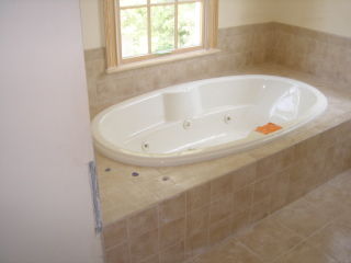

My money is on it's tiled over, under the tub.
Some tile guys set the tiles where grout lines line up with the access door, good luck finding where it is.
I got lucky one time tapping on the tiles with the plastic end of a screw driver, when it sounds good and hollow you have probably found an edge.

access panel on the ceiling in the room underneath?
Probably on the right front about 18" to 24" to the right of what looks like the orange sticker. Check with the manafacturer though. Electrical code inspection red flag! All elctrical connections must be accessable. Based on this and your other pic/thread, is this an owner builder deal?

if they cant get underneight , how do they finish the plumbing, all i see is three holes.
What is your part in this project?
Is there a closet on either side of the tub? There might be an access panel there.

I'm thinking thats what the other pic is.
Yea I comprehend now. Exploritory sawzall time. kidding.

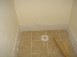

Second pic looks like a closet flange set too close to the wall, unless those a 18 inch tile. What about an access door on the exterior of the wall behind the tub? We did one like that but there was a small observation deck on ours, just behind the tub. As was mentioned, there needs to be access for the electrical too. Just my two cents!
I've seen some doozies of those, on 1/3 & 1/2 million house in Austin. Often in clearly, "oops" situations to cure red tags. (No lintel in the brick over the plywood panel that just has 4 screws run into the framing behind, with a 4 ton a/c compressor 6" in front of that . . . )Occupational hazard of my occupation not being around (sorry Bubba)
If the plumbers are really, really lucky--there's a panel on four touch latches that the tile are adhered to (and the grout guy did not know about). Very slick that way, you push in with both hands and the panel goes in, then pops out to where it can be removed.
If they are ordinary lucky, the panel is on 4-6 magnetic catches (and the grouter didn't know). This is less good, you have to have a real thin, flexible, sort of device to reach back behind the u/l to pry the magnets apart. Plumbers often do not have such fine tools available, and some will pry at the tile rather than the u/l supporting it.
If the plumbers have not lived a life of humility & charity, they will find that the tile people ran u/l right over the access, tiled & grouted right over all that, too.

On ours, GC said that the access would be through the exterior wall. It was vinyl sided and easy to strip and remove the piece of plywood, so we put up backer and tile over the entire front skirt with no panel.

Usually the pump is on the end opposite the drain, or if the drain is in the center of one of the sides, it is usually opposite the tub filler location.

it's all open from downstairs ...

I'm still curious as to where it actualy is. It's hard to call it a goof if you don't know the real answer. It may be a pretty simple solution.

Everytime we put in a jetted tub, pump access location is usually a coordinated effort between the electrician, the plumber and myself (hands-on G/C). Sometimes you have to special order the tub with the pump placed at the drain end. Fellow local contractor had to install one with the pump shipped seperately and had it plumbed into the unit in the field a couple feet below the tub in a basement utility room.
I did one last year remarkably similar to the one in your photo and we put the access door in the wall at the foot of the tub and behind what would be the head of a bed. (the small bedrooms in some of these large houses don't leave much flexibility for furniture arrangement).
We trimmed out the little door and, even without the bed there, it blended into the wall better than the intercom master the HO put in their kitchen.
In my locale, at least, I can be assured that both the electrical inspector AND the plumbing inspector will verify the pump access during final.
