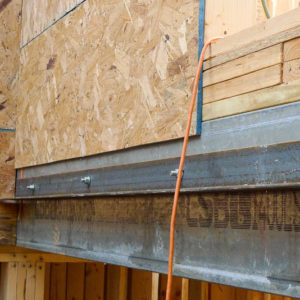

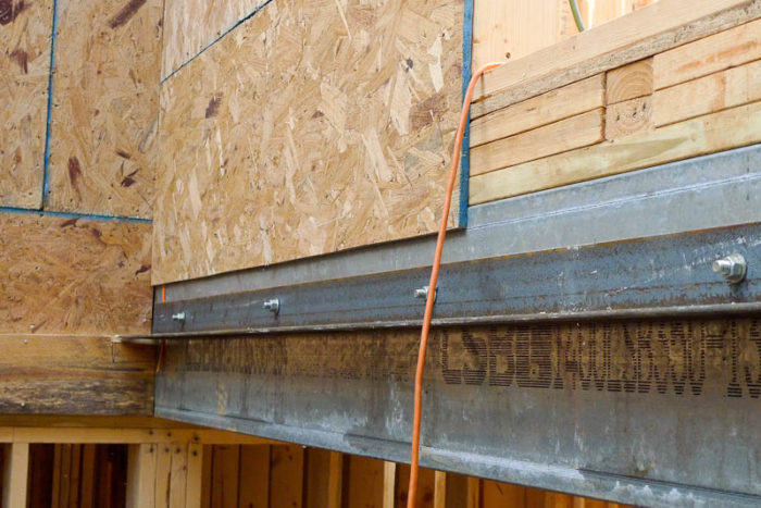

We just set our first one last Friday, 17′ span carrying 4′ of floor trib, an 18′ high wall load with the first 8′ covered in stacked stone, 4′ of roof trib and 3′ trib of 4″ concrete slab and flagstone porch. Total design load 1268 lb/lft. I ran it on BC Calc and it came out as a triple 16 LVL at similar deflections. There’s living space in the basement underneath the porch and I really don’t like carrying concrete on wood anyway, so the truss designer suggested we try one of these.
Single 14″ x.134 LSB carried it, according to the company designers. Rented a rescue saw to cut it with, cut 4 stiffeners for the ends and attached them with Buildex screws, drilled holes 2′ OC for the concrete lintel with a step bit(any of you ever price one of those? Youch!), set it in place, weight around 230 lb, more or less, then used more Buildex screws to attach a plate for the top-bearing trusses. Buildex screws are pricey, too, and they come in 250-count boxes! So I’m stocked on screws for the next few jobs…
It was raining on and off, it was Friday afternoon and I was chasing checks to boot so I didn’t pull out the camera, I’ll try to get some pix tomorrow after the pan metal and lintel are installed. We’ll have to measure and install steel tube columns at the ends to finish up the job.
Overall first impression is that I like this thing! A little different to work with but it beats the heck out of wrestling 16″ LVLs around and laminating them in place. The trip LVL would have weighed almost twice as much(8 lb/lft/ply vs. 13 lb/lft for the LSB), setting it as single plies would have been my preference but you’re still dealing with 130+ lb beams and you have to repeat 3 times then climb up on a ladder and screw or drill-and-bolt it together. Then drill holes for the lintel…

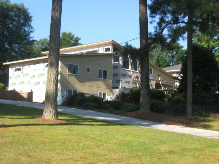

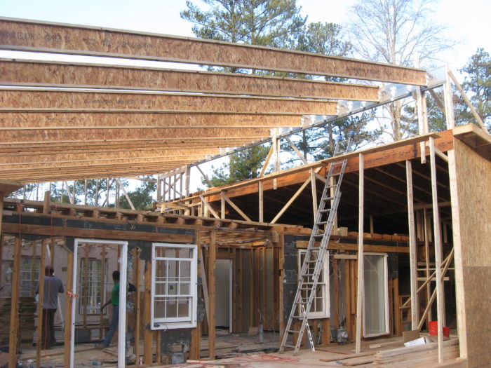

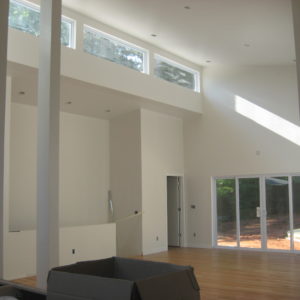

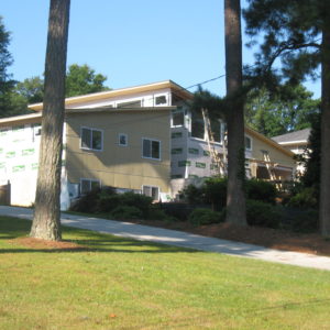

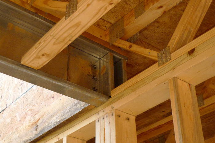

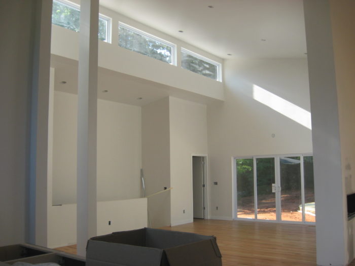

We just completed our first project with LSB and plan on using it again soon. We had a client that wanted a large open span in a contemporary home here in Atlanta and did not want to see any headers or beams sticking out below the cieling surface. We had to come up with a 26 foot span that would hold roof framing made up with wood I-joists. We connected the I-joists with slopable hangers and self tapping screws to the LSB. On the other side we also welded some angle iron for supporting accent soffit of sorts on the high side of the roof. I will be posting videos and photos on my site shortly http://www.kevinbuckleybuilders.com As promised we were able to cut it in the field and my framer was able to handle it with no problems. It really is cool stuff I will attach a picture below:
Nice looking job, Kevin!
Did you actually manage to keep part of the old structure and incorporate it in the new design?

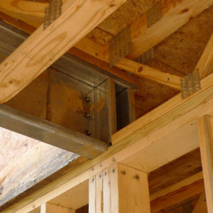

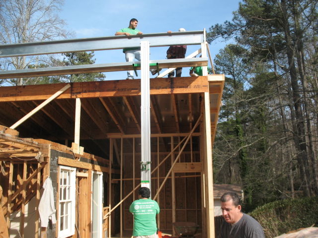

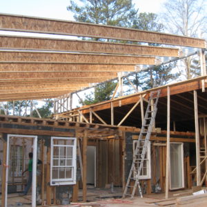

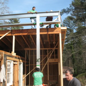

Our project wasn't nearly as impressive, just holding up a concrete/stone porch slab and stacked-stone on the wall. Here are a couple of photos of the install, I'll post some more when they get the stonework done. The 2x6 posts are temporary, they'll come out and be replaced with steel.
Best,
Bill
