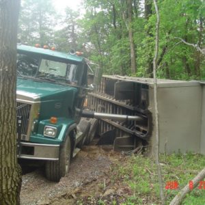

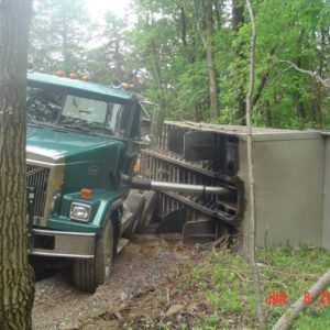

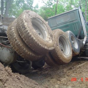

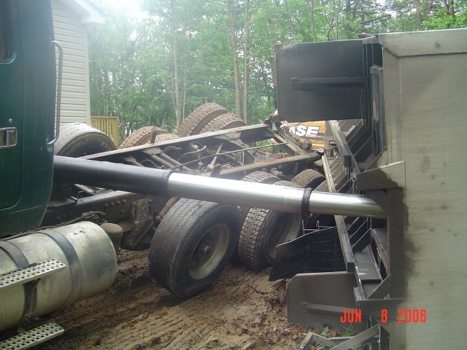

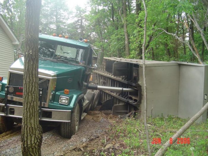

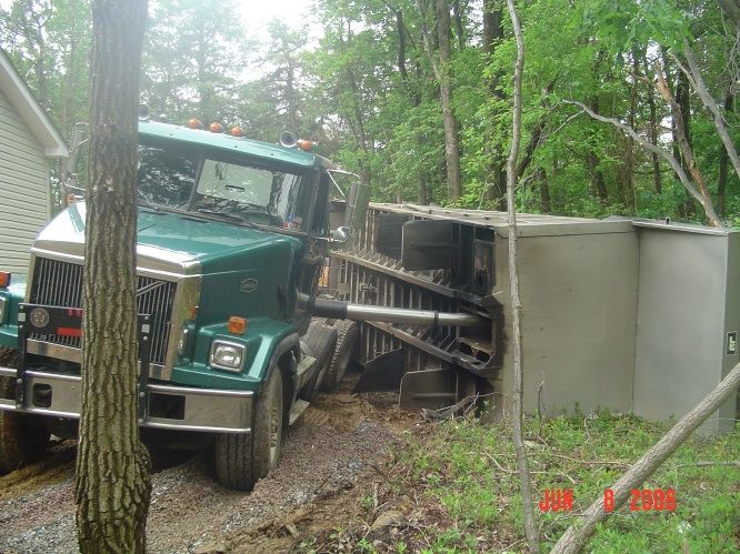

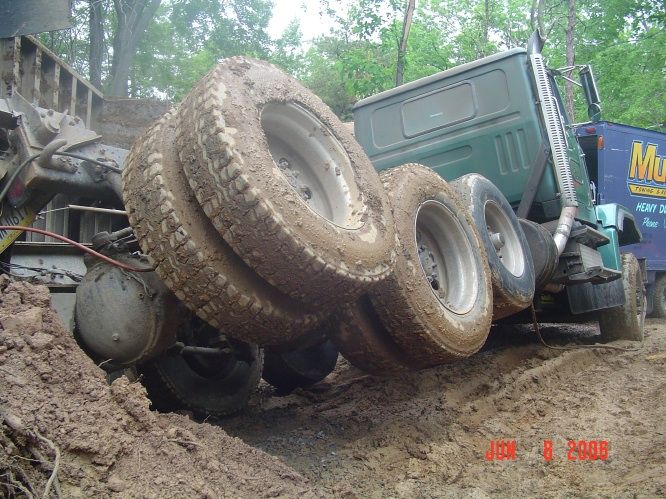

I am inside trimming a house, outside the excavator is working on a septic. Dump truck with dirt comes to dump, now its been raing on and off for a couple of days here and things were pretty muddy. Any way he starts dumping and I hear some yelling to lookout, I’m thinking that he is getting to close to the house, and then all of a sudden a big bang, so I run out side to see the dump truck on its side. Apparently when he went to dump he started wobbling and tried to let it back down but it was too late and as she tipped the piston snapped. Luckily nobody was standing next to it, The driver was a little shaken but o.k.

    Izzit me, or is one of the dump pivots busted of the end of the frame?
    Traditionally they are the only thing less well maintained than trailer axle stubs (c'mon, be honest, when was the last time you actually pulled wheels & bearings, and cleaned & packed those bad boys?).
    I know I've heard a few of the pivots complain a time or two, when the frame was not quite level, and that load goes up.
    Saw a "pup" dump trailer the other day that clearly had some sort of problem--driver was going verrrrrrrryyyy carrreeefullly down the road, which was logical with the dumpbed up about 45ยบ . . .
    1. Fotze | Jun 09, 2006 02:30am | #7
      yes
      the left hinge remained intact while the right snapped, luckily it snapped or it would have tipped the whole truck over. The tow truck guy torched the right hinge off and they were able to drive the truck away after plugging some airleaks(tailgate line)

      My buddy owns the truck (2 payments left) and it was his father driving who is normaly a very concientious driver, but he has been complaining for a while that the body would not come down, it just took to dang long

    Usually happens when truck isn't level when dumping, or the material being dumped hangs on one side while the other side brakes loose. Looks like material was a heavy loam and wet to boot, lucky driver could have been alot worse

    I did that once with my old one ton flatbed dump. I had way too much concrete chunks loaded onto it and was not quite level as I dumped. One hinge pivot sheared off and the bed toppled over sideways. It cost me a few hundred dollars to get the scissor hoist straigtened and the hinge pivots beefed up. I got off easy relative to your guy but it taught me the hard way the importance of having an evenly loaded truck and dumping only if the truck is on level ground.
