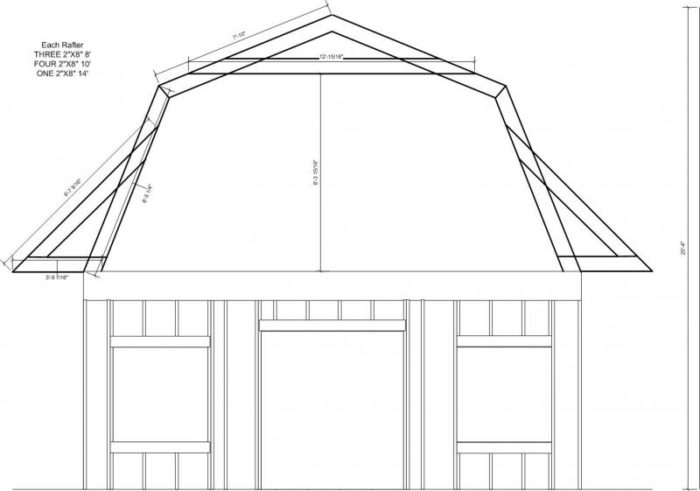

Here is a rough drawing of where we think we are going. Thanks for the input
If you are finishing and insulating the ceiling then you have 2 options.
1 have low vent, high vents, and maintain an air space between the from top to bottom.
Dependeing on the insulation and the way tht it is installed that might form the air channel or you might be baffles the whole way.
Or you could make it a "hot roof" and have continous insulation and no air flow.
IN any case with 7 1/2" you will probably need to build out and install insulation over top of the rafters.
