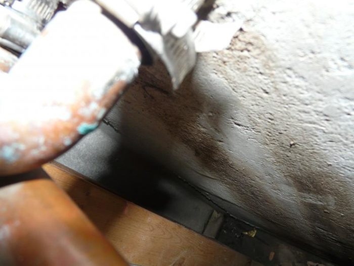

Well rain came and water got in, it didn’t make any sense to me that it could come from the window so I did a test myself. I put a hose outside running close to the house where I thought the leak was and voila I could see the water coming in, but not near the window. Basically there are two pipes coming into the house, one is clearly the water main of the house, the main shutoff is right there. The other pipe I am guessing might go to the other side of the duplex, who knows. The water comes through the foundation on the two holes for the two water pipes. I was able to see this because there is an easy access panel covering these pipes right next to the window. After looking at them for a second I noticed there are water stains below the pipes.
So my questions are, how do I go about fixing this? a contractor quoted me 1K to drill some holes and inject some sort of thing in there, is that correct? should it cost that much?
And my other question is, shouldn’t the inspector have caught this? I mean there are big water stains under the pipes and I didn’t have to do anything special to see them. Should I bring this up with the inspector? it isn’t as much about the money, I just feel like, what did I get the place inspected for if they didn’t even catch that?
I’ve attached a picture of what I could easily see.

Can you take another picture or two , and this time back up a bit.
That picture is such a close up that I can't even see the arrangement of the pipes nor the entry through the wall .

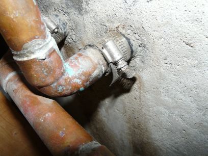

Shows 2 copper elbows that appear to be tied into a stainless wrapped ferncos that disappear into the concrete. I can see the stainless band and the hose clamps.
Actually the edit was to mention I had attached a picture on the original post.I'm attaching a few more now.

You can take a guess as to what the connection between the pipes is then. But on the patching issue... I have used spray foam shot in along side the pipe, let it cure, then cut it back just a bit below the surface of the crete and use a good poly caulk or hydraulic cement to seal things off.
Used that technique a lot on "she" bolts from 12" CIP walls with much success.
here's one of'emTFB (Bill)
Hard to tell whether it's plastic pipe running through the wall, or if it's just a plastic sleeve around the copper pipe.
As I stood before the gates I realized that I never want to be as certain about anything as were the people who built this place. --Rabbi Sheila Peltz, on her visit to Auschwitz
now that I've seen a photo, a sleeve is what it looks like to me, since copper should never be run thru crete in direct contact.the staining is very slight, but can't tell without watching a leak whether it is water running thru on the outside of the abs sleeve or between it and the copper. if the latter, some geocel on the outside will take care of things.i might even speculate that the clamps are there in a misguided attempt to keep water out, and there are no clamps on the exterior side of this gumbo.

It's often hard to tell from staining whether the problem is a flood or just a few drips, possibly due to condensation. (It's also hard to tell anything from your picture.)
The right way to fix this is to dig up the area on the outside and seal it. I can't tell from the picture how deep down the pipes run, and your profile doesn't tell us where you live, so I don't know how much digging this implies. But if the water soaked down to it that easily it couldn't be too deep.
We are in Kansas. Its on a full basement, I'm going to guess the pipes are 4 or 5 feet below ground level.
