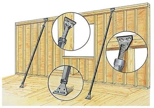

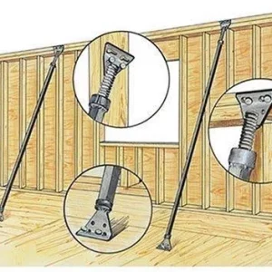

  6. BobboMax | Feb 26, 2022 06:00pm | #8
    Another helpful tool for standing walls up safely by yourself is wall braces. Check out https://www.acmetools.com/adjustable-wall-brace-2620/012643026200.html?feeds=shopping. I suspect Acme is a bit pricey, so shop around.
    A wall brace is basically 10' of tubng or 2" angle, with nail plates at each end attached by threads set up like a turnbuckle. Their basic purpose is plumbing and aligning walls- as you rotate the angle, the nail plates move together or apart, moving the top of the wall in or out (it should already be attached at the bottom plate.)
    But you can also use braces to make it safer to stand a wall up. Lift it with jacks until it's just shy of vertical, still leaning in, then nail off a brace that's intentionally adjusted to be a few inches short. Then you can extend the brace to plumb the wall, while still having complete control of it.
