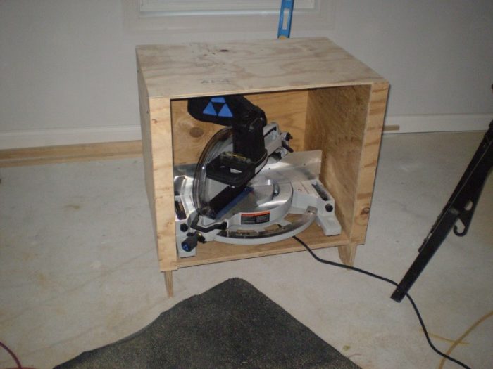

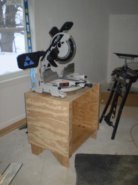

I made a saw stand for my new Delta that allows me to tuck the saw underneath for use as a work table. When the job is over I tip the stand on its’ back, pull the legs and stow them with the saw…from stand to tool box.
The stand was built to match the height of my table saw and 10″ SCMS.

Sharp looking saw... Seems that might be a nice alternative to the DeWalt 706/716 for vertical capacity. I'll be interested to hear how she holds up.

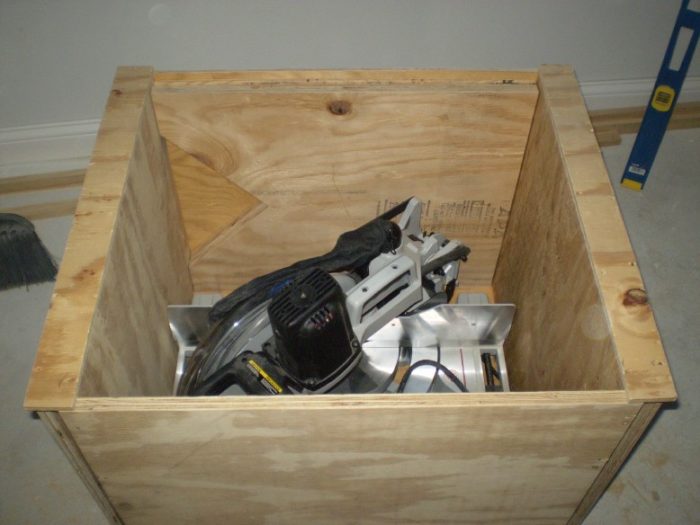

Nice. I can't figure out how the legs fasten into the stand. I can spend a few more minutes looking at the pics, but that may strain my feeble brains too much. screwed into the sides?

Thanks for the kind words and glad to know you have had some good Delta stuff.The sides of the stand are double walled, with a 3/4" slot to slide the legs into. The fit is snug...but not too tight. Works well and is very stable. The top of the slot has a stop screwed in so the legs (just the right length to fit inside the box) produce the 36" height for the saw.
Thanks. I thought about that too (hard to believe) but coudn't see the slot in the 3rd pic.
Please post again when you come up with Ver 2.0 and add more features.
