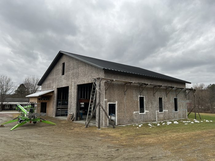

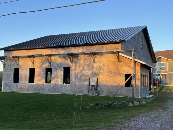

I have been building a workshop for the past 4 years (plus a couple years of site prep).  4500 sq ft … 16 ft ceilings … standing seam metal roof … I have put every nail in myself.
Before it rots away, I need to get siding on it.  The outside is about 6000 sq ft.
I looked at vinyl … about $2 sq ft … pain because I would need to start at one end … go across with a few rows … then move to the end again  … plus I would put PVC trim on corners and such.
I looked at LP and other types of manufactured siding … $$$$$$
Looked at metal board and batten .. $3 sq ft … maybe I could do this.
Then I looked at Board and Batten (or ship lap board … same price).  About $1.50 sq ft … looks like reasonable to put up.
Now, if I go with board and batten, I have a few questions:
1) The lumber mill said the most important thing is air moving behind the wood.  So Furring strips?  If so do I need a lattice of them to leave a gap or ?  Do they need to be pressure treat or ???
2) Do I need to protect the wood?  I know some people say just leave it.  I am worried about it rotting.  Maybe a dip tank so all sides get coated?  Treat with what?
3) How to butt pieces?  Some say to end them all at one point and put a Z flashing .. some say just butt them … I was thinking a 45 on the ends so water does not run back behind the boards.
4) How do you buck out the windows?  if you put Tyvek on the building and wrap it into the windows, what do you do to get the windows out 2 1/2 ” (3/4 back furring … 3/4 cross furring … 1″ boards)?
5) Board and batten or ship lap … board and batten holds water behind the battens but ship lap holds water at the overlaps.
6) anything else I should be thinking about?
Thanks …. Mike

    I like the Coravent strips but have never opened up a board and batten remodeling job and had the horizontal (plain pine) furring strips be rotten. There is a ton of air moving through B and B on furring strips.
    How long has the OSB been exposed? You should cover with some type of paper or house wrap if you can't tackle the siding this summer IMO (2025).
    Gutters and snow slide guards in the plans? You will have a splash back on the eave walls to almost the bottom of the windows. The bottom 12-16" of siding will deteriorate much faster than above it. If no gutters, maybe consider a wainscoting of steel with the B and B above it.
    1. xtal_01 | May 29, 2025 10:11pm | #8
      It's a looong story but some of that osb is going on three years ... ouch! I thought it would have rotted away but it is actually in decent shape ... just a few spots I need to look at but most is solid.
      I am planning to cover the entire building in Tyvek this summer and with luck all the board and batten up.
      I am not going to put gutters and yes there is a LOT of back splash ... this was the first winter with a roof and I found that out quickly.
      First, I am sealing the bottom 18" with truck bed liner (a could inches onto the cement right up the OSB). Not cheap but it will seal the bottom edge. That is another long story ... I wanted 12" of concrete but was told by several builders and the guy who put poured the slab to build on slab ... mistake!
      I will put at least two pieces of material horizontal on the bottom edge. This will take the hit from a lawn mower or weed eater ... and will rot ... but if I screw it on, I can easily replace it.
      Crossing my fingers it all comes together. This one man building is for the birds! I did try to hire people. The first guy could not put up anything straight if if life depended on it. The second guy showed up drunk ... did drugs at lunch and either passed out or just took off for a few days!
      In the end, it was just less frustrating to build it myself. I have done it all from putting up the trusses to pulling up the roofing panels.
      On top of this, I work and I take care of my wife who was paralyzed from the shoulders down as the result of a diving accident when she was 12.
      Anyway ... just got in. Working on the small shed roof in the front. Then windows and siding.
      Windows! $5K for cheap vinyl ... $21K for Marvin Essential (the old Infinity line).
      Thanks for the advice !!!!!!!!!!!
      Mike
