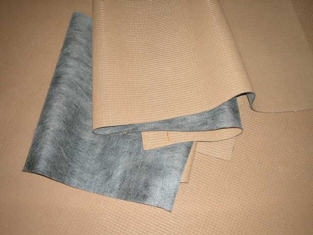

the underlayment is from Wilsonart.
can't find the label I dug outta the trash can right now ...
lost it somewhere between here and there ... it'll turn up.
Just tried to check their site to find it ... all I could find was the regular cheap foam stuff ... this stuff's more like a fabric covered rubber ....

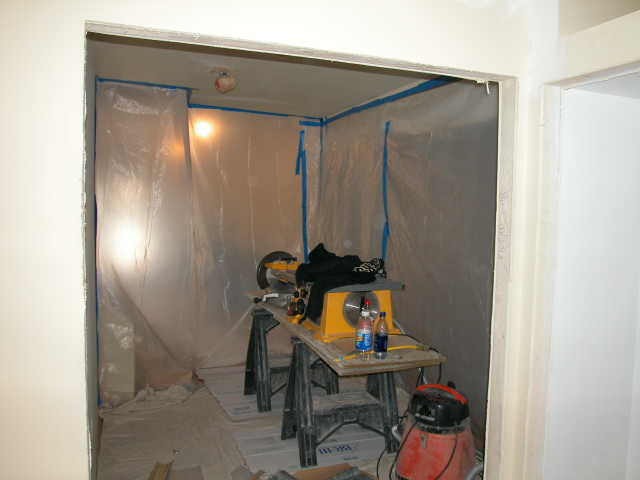

Took some quick pics of a dirty job site/work in progress...
will download later tonight.

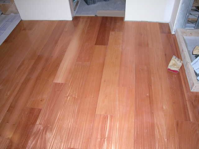

I'll save the good pics till after we wipe all the sponge smears ...
But here's a teaser ...

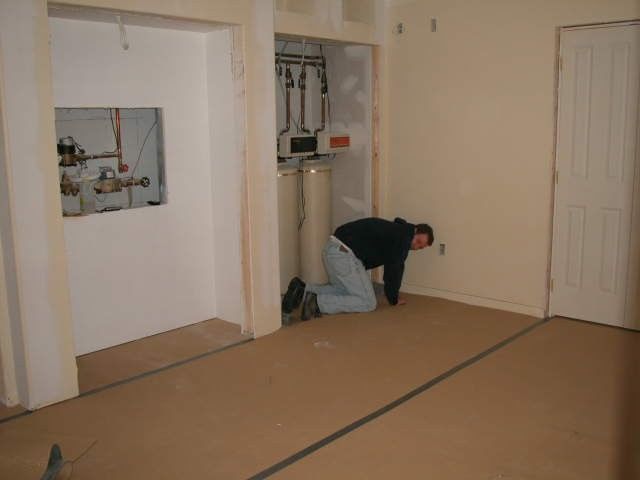

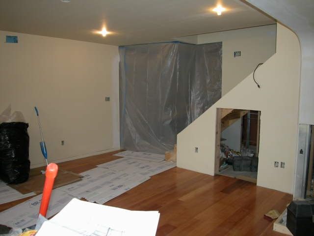

The last of the new floor pics ...
shows the work station after we got the glued floater wrapped up except for the kitchen area ...
and now have to start Mon ... poly and underlay down ... to start click-locking the floater in the "exercise room" ...

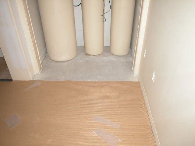

Here's a few pics of the materials ...
