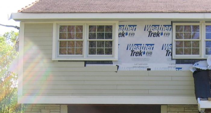

            DDay | Jun 10, 2006 08:17pm | #27
            I like Azek for the water table, the wood ones just don't last with the water.  It's not cheap but it will last forever and looks great.
            For this I used 1x12's and cut a bevel then use the two pieces to make up the table.  The Azek rips well but your arm looks like a snow man after the 18ft.
            I make up the corners of the water table with 5/4 Azek and rabbit out enough for the 3/4" azek to fit in, this allows for the expansion/contraction on the long runs and also gives a little shadow line at the corners that I think looks nice.
          6. billd60 | Jun 12, 2006 05:17am | #35
            Any chance you could post a simple drawing of the water table you make?  I'm about to start a FC job (my own house) and have been scratching my head on this very detail.  I like the AZEX idea too.  Does it really take and hold paint?
            DDay | Jun 12, 2006 05:50am | #36
            I'll post a close up pic tomorrow (remind me if I forget).  It's simple to explain though.  It's 1x12 Azek that I rip at a 30 degree bevel, I've seen 45 degree, 10 degree, etc.  I like the look of 30 the best.  The bottom of the table is 9" at the long point, so the angle piece is about 2 1/2" to the long point.  I've seen a lot of builders do it with a 1x10 and a 1x3 but then you don't have the angle on the bottom piece which makes it easier to line them up.
            The pic I posted is on the second floor.  That would look stupid with the regular water table, so that one is different.  On that one, I didn't want just a 1x8, I wanted a shadow line to add to it a bit.  That one is just a 5/4x2" top piece and a 1x8 on the bottom, glued the entire way.  I really do not like the look of drip caps.  On top of a window is fine but in the front of the house, I did not want the long stretch.  So the 5/4"x2" top piece is beveled at something like 10 degrees.  That pitch should be enough to keep any water out, the siding stands off the house close to that, so only the very outer edge could get any water.
