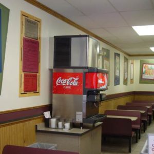

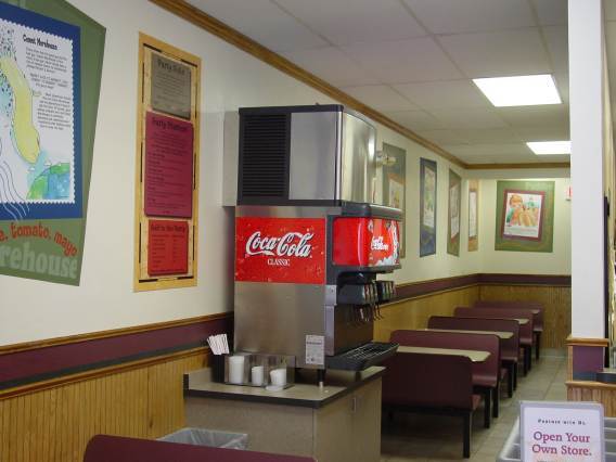

    I just did what you describe last week. I ordered one-sided melamine to make a soda fountain, self-serve base cabinet for a sandwich shop. What showed up was white melamine on one side and brown melamine on the other side. I was trying to avoid your dilemma, but oh well.
    I laminated the brown side, after sanding with 80 grit. I usually use water-based contact cement, but decided to use the smelly, flammable solvent stuff--since melamine is not exactly porous.
