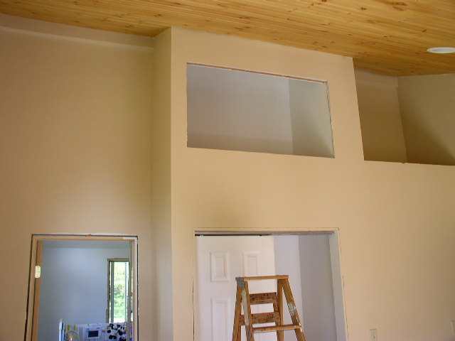

I’m trying to complete a job left undone in a recent small home renovation, and have a question on recessed lights clearance/ventilation.
In the addition, we have two closets, each with a recessed light in the ceiling of the closet. The rooms have cathedral ceilings, so above the closets we put an opening in the wall to gain additional storage space, sort of a second story closet. The bottom of the “second story” closet would be over the recessed lights of the main closet below. I’ve attached a pic of the closets and the currently unfinished bottom of the upper closet.

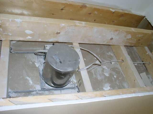

I unfortunately do not have any paperwork on the specs of the lights, and the fixtures themselves do not have any labeling that I can see, so I don’t know if these lights can be fully enclosed. The plan had been to put a “floor” on the bottom of the upper closet, setting it on top of the 2×6’s seen in the pic labeled “bottom upper closet”. My concern is that these lights would then be fully enclosed, and of course I don’t know what sort of heat build-up might occur.
Is there any way I can tell from the appearance of the fixture if it’s ok to enclose the space above them? Am I worried needlessly? Or, should I leave a space around the edge of the “floor” of the upper closet (I am planning to use 3/4″ melamine) – it would not be a problem either structurally or aesthetically to leave a gap on the sides, only a place for small objects to lose themselves into.

Look on the label on the inside of the can and see what it says about insulation contact.
Also get the model number and then you can probably download a spec sheet.
If there are no markings on the cans, and things are still open and accessable, why not replace them with cans rated for insulation contact. That's probably less expensive (and faster) than trying to do a lot of research.
You shouldn't have a problem "enclosing" the cans. It's no different than putting recessed lighting in a ground floor room of a two story house.
If the light cans are UL listed, they will have thermal protection. If the thermal protection causes the lights to wink off after a time in operation. come back in and install some round drilled in soffit vents in the floor of the upper closet. I don't think you sill need to do that. The uninsulated space will dissipate the heat.
They look like JUNO model IC22 cans. IF in fact they are, then you can bury them in insulation. If there is no lable and no other way of identifying them, I would replace them. Ten to fifteen bucks each depending on where you get them.
Nice call, bos'n. Took the can apart a bit, label says Juno IC22.

Thanks all - too the can apart a bit, found the label, looks like they are IC rated lamps, so I can enclose without worry. I also found what must be the heat safety cutoff, right on top of the can. I appreciate the assistance.
