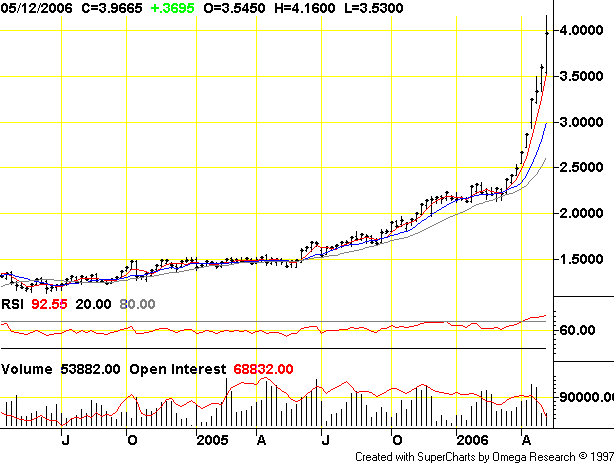

Much worse than gas prices:
a little red X would be worse...
like a laser and cross hairs arangement...Life is not a journey to the grave with the intention of arriving safely in a pretty and well preserved body, but rather to skid in broadside, thoroughly used up, totally worn out, and loudly proclaiming<!----><!----><!---->
Your picture didn't come through.
"The difference between greatness and mediocrity is often how an individual views a mistake..."-- Nelson Boswell
Hmmm. Some people saw it, but now I can't see it either.
See attached:
That's an ugly curve.
