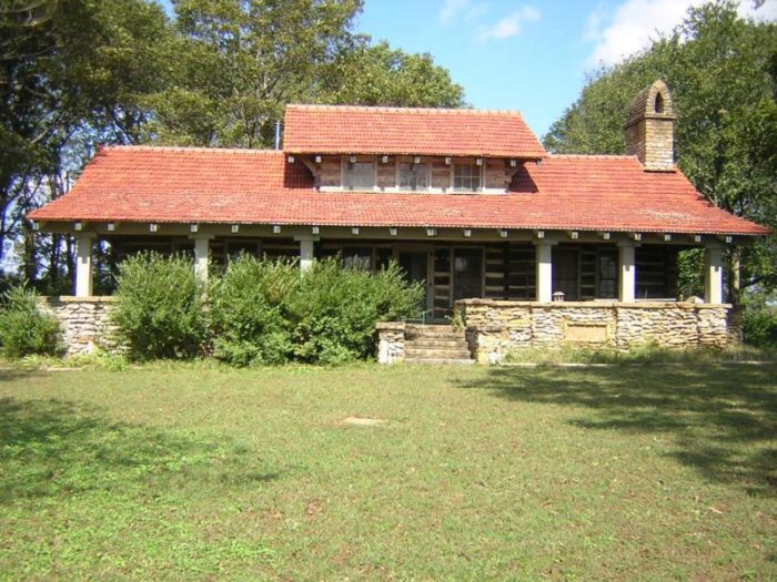

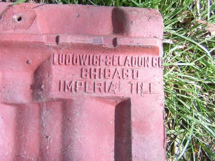

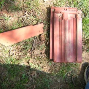

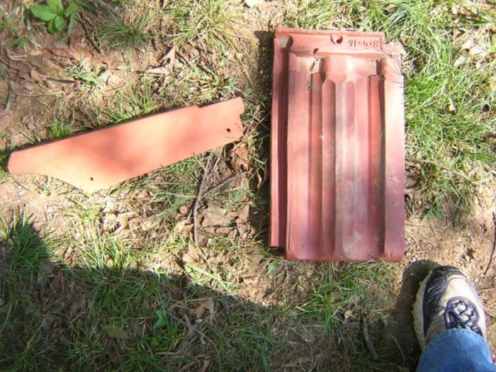

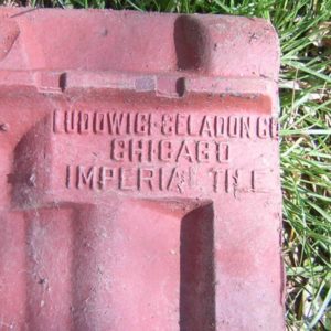

I’m redoing a French ceramic tile roof repair on an old cabin in a few weeks.
My question is does it really matter to use copper roofing nails with the tiles or would galvanized roofers be alright?
I understand galvanic reactions with different metals but a ceramic or spanish tile roof is not going to cause any reaction.
Here’s a photo of the tile and roof.

    Cool looking place.
    While you are there, could you move that second joistbeam from left so it is on layout for me. I hate lookint stuff that is throwing my eye off like that.

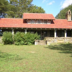

      The need is to repair a small patch on the back porch roof but this is not a roof you can just pull up a small part of. You have to stagger back a lot. So much co for this repair I'm just going to remove it redeck and reinstall.
      Here's a photo of the back roof.
