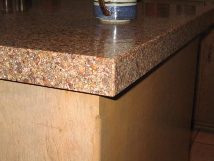

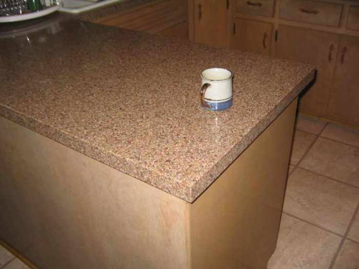

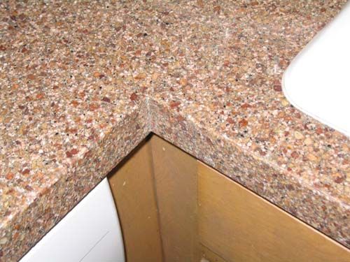

          9. tomfintosa | Sep 16, 2004 02:48am | #13
            I've attached 3.  This is the first time I've posted pictures, so I'm not sure how they will look.
            Remember, the basic material is only about 1/4" thick, but the way the edges are fabricated makes it look like a thick slab.  You really can't see the seams in it al all, at least I can't.
            --Tom

          11. JohnT8 | Sep 16, 2004 11:35pm | #15
            Doug: The larger pics allow you better surface detail, but I went ahead and resized Tom's pics.
            Tom: You say they installed the 1/4" granite overtop your existing countertops?  What type of counter did they install over, flat edge?
            Looks DARN nice!  I've always liked the look of granite countertops but typically started laughing when I saw the price tag.  This looks like it may offer a lower cost option.
            jt8
          12. tomfintosa | Sep 17, 2004 01:55pm | #16
            The existing countertop was a vintage 1962 plastic laminate with square edges except at the outside corners which had a small radius.  I think the material could have been fabricated with a similar outside corner radius, but I liked the complete square edge look for the new top.
            The material is about 1/4" thick and is a granite/polymer mix on a mat of some type.  I think there's more info on the material at the web site given in an earlier post.
            --Tom
