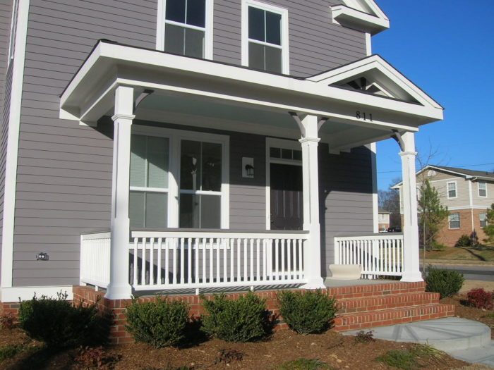

I did some a little bit similar.
Used a band saw on #1 KDAT 2x lumber. See attached pic. I don't use raw (untreated) wood on the exterior of homes. Maybe I should start to provide more job stability for people who fix houses... Being semi-serious here. :-) since new construction isn't looking too good on the home front....
Really though I've built a number of houses with those kind of eve brackets on them. It's best to buy ready made Fypon brackets whenever possible. Sure, there is some initial sticker shock, but after that, it really is the right thing to do. I'm building a building now that used 12 - I think it was.
The reason I made the ones for the above house was that I just couldn't find anything anywhere that fit what I wanted. I didn't have ready access to a band saw so I went over to a trim carp's shop to use his. That was a one time deal since I haven't hired him since that house as his guys didn't do a great job. If the KDAT wasn't available I would of used PVC lumber, laminated as you are proposing, which would have been even more time consuming. I'm thinking I had around 6 hours in those 6 brackets as it was - plus materials and gas. If I coulda found what I wanted in ready made Fypon I'd guess a price of $30 each, so I woulda come out ahead with store bought.
