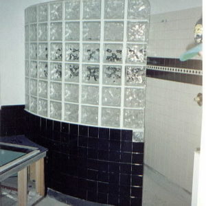

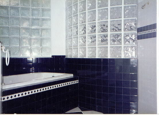

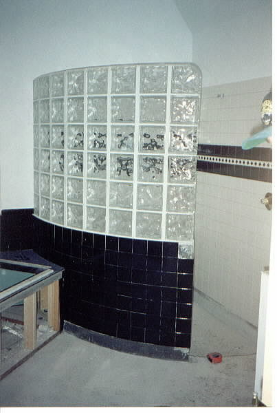

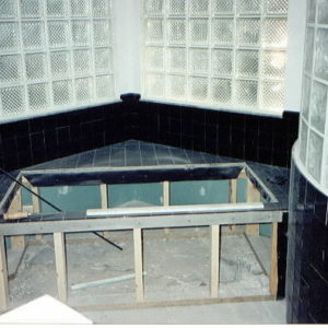

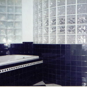

  4. RalphWicklund | Nov 25, 2003 04:10am | #12
    Built this bathroom about 7 years ago. It's still standing.<G>
    Don't remember the radius - possibly 2.5'
    Used standard 8x8 glass block for the field and end blocks with the finished edge for the top and end of the enclosure.
    Mortar joints. With a radiused enclosure the joints are regular width on the inside and about 3 times that on the outside. A narrower joint could have been achived using the 4x8 blocks. 4x8 (4" wide, 8" tall) might be the way to go in your case.
    The photos are really in color but the homeowner had this thing for a total black and white bathroom.
