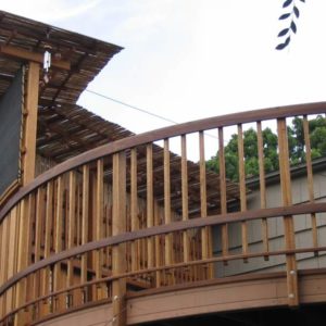

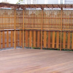

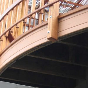

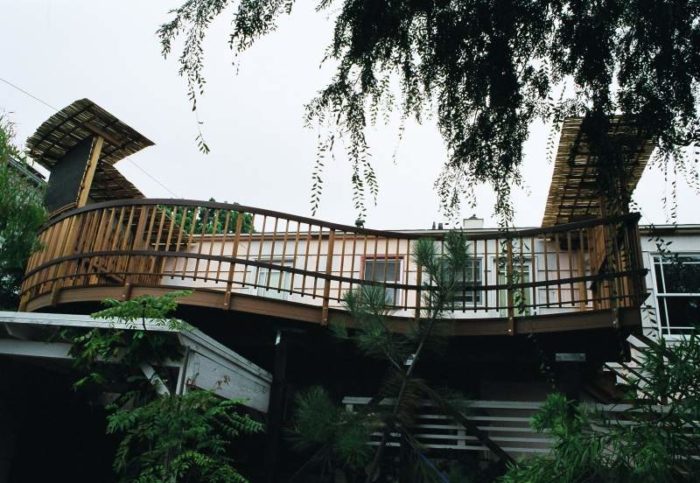

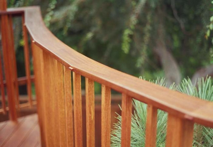

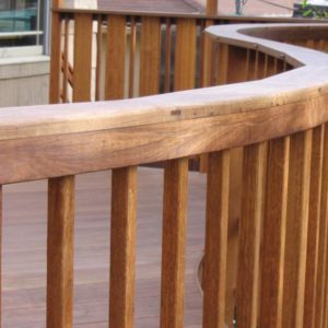

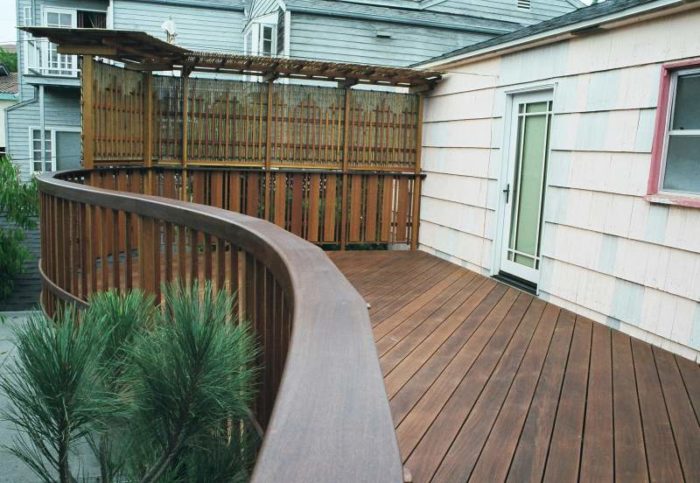

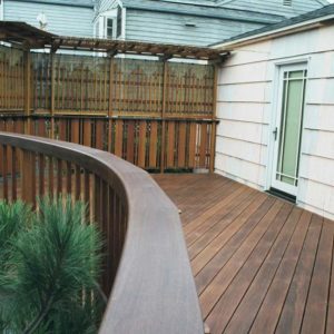

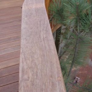

Thought I’d show one of my decks too ! This one has ipe decking, screwed and plugged. The top cap on the rail is also ipe.

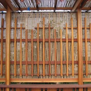

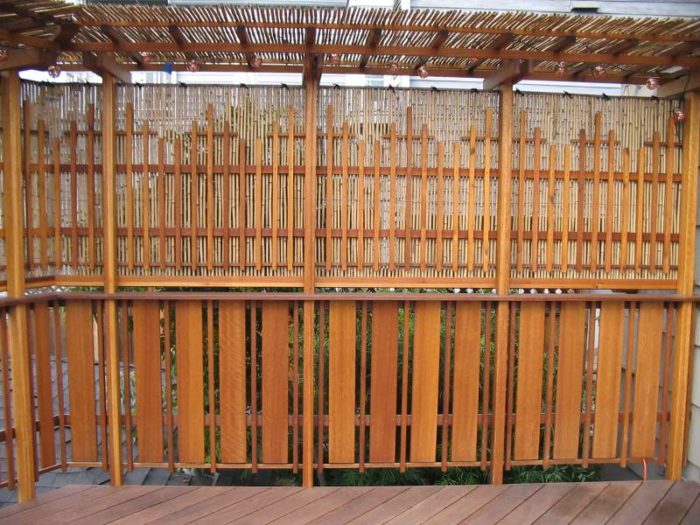

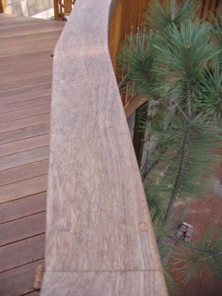

The railing pickets are meranti, and most of the screen, and pergola elements are WR cedar. The decking is sealed with Seasonite, to let it go silver, and most of the rest is sealed with penofin, to retain the color.

    ProDek | Nov 25, 2003 07:55pm | #1

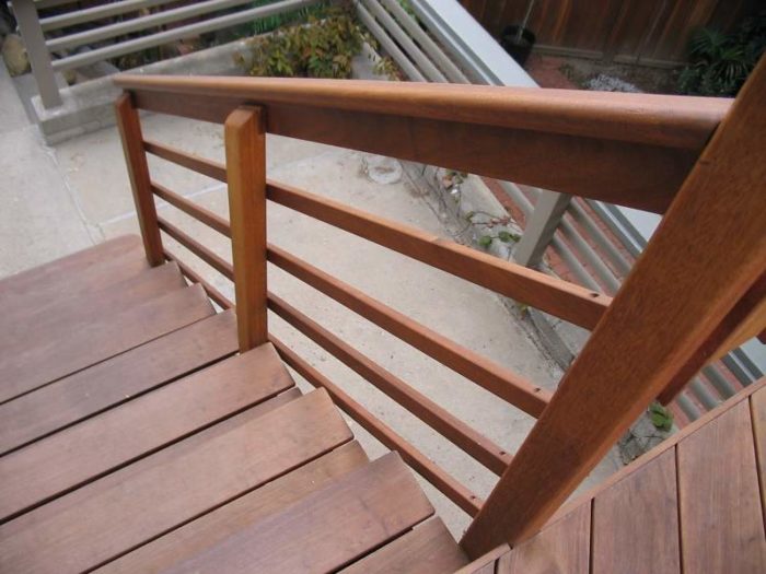

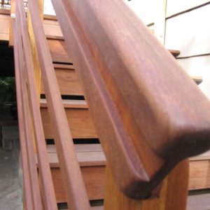

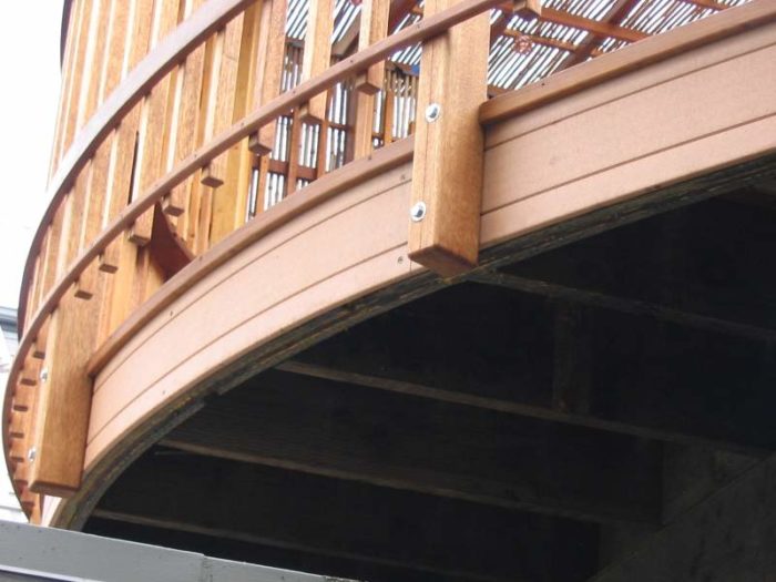

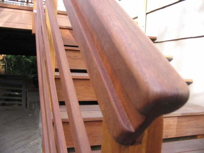

    Nice shots Joe, Is that Trex you used for fascia? I like the handrail detail. Tell us how you made the cuts and what you cut it out of.

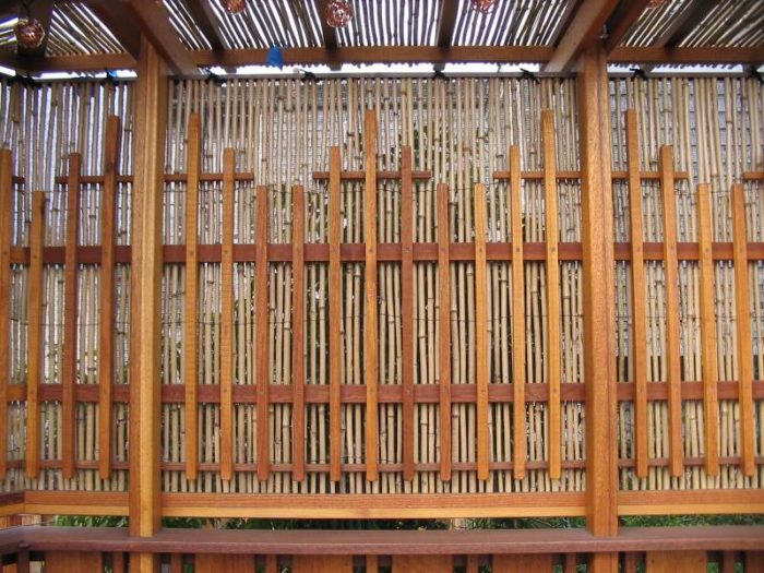

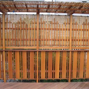

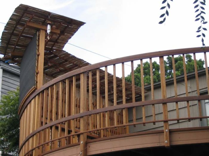

    That bamboo looks like a pain to work with. Did you have to pre-drill and screw each piece?

    1. joewood | Nov 28, 2003 12:32am | #2
      No, isn't Trex facia, but one of the other composits .. can't think of the brand.

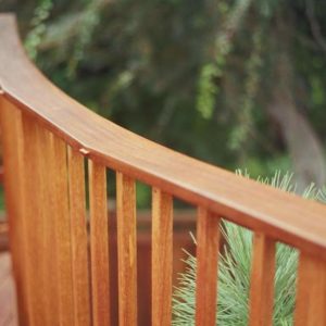

      The handrail is laminated ipe, with a long dado down the one edge.

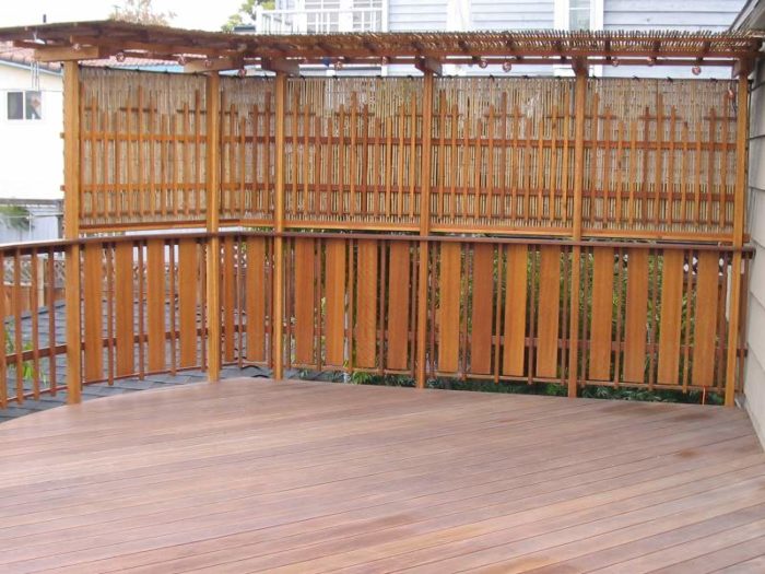

      The bamboo comes in rolls, but is still a bit of work to cut to length, and then yes, we have to screw every 10th or so cane to make it stay put.

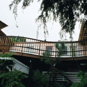

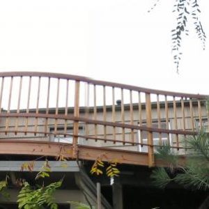

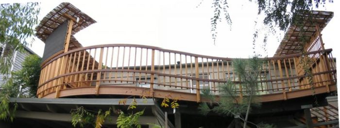

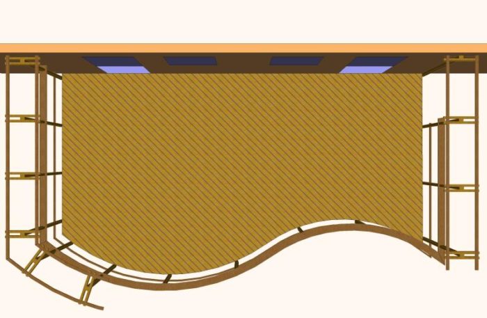

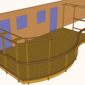

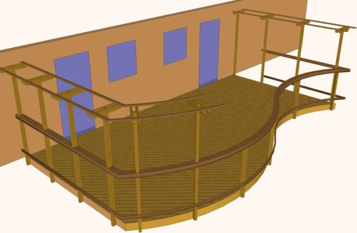

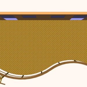

            OK,  I'll do a few at a time here then.  The first two are CAD images, the next two are overall pics.

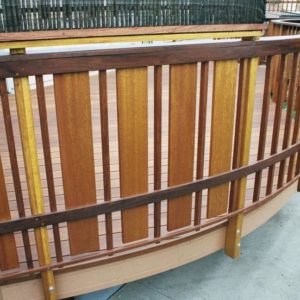

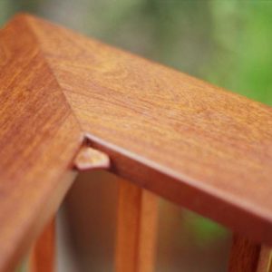

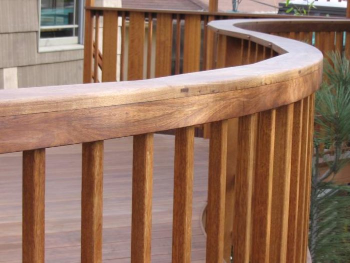

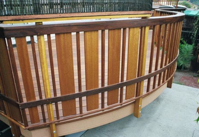

            Here are a few of the railing.

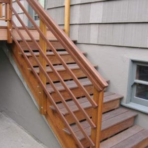

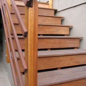

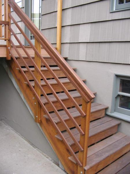

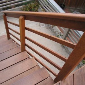

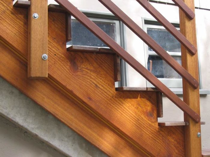

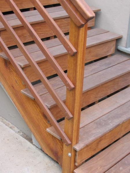

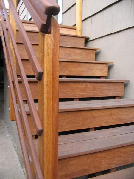

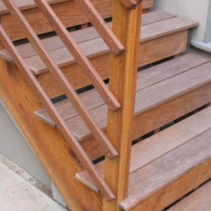

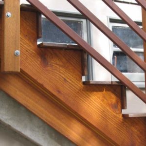

            The stairs are ipe .. except for the WR cedar stringers, and the meranti posts.

            The screen and pergola, and facia.
            man ! I'm tired, and, full of turkey ! Pretty nice job, hey ? Wish I could finally make some decent money doin it though ! Ah well.. it's what keeps me going !

            Some of these are 4 months old, and the other are just after it was complete
          7. Piffin | Nov 28, 2003 08:04am | #15
            Thanks, Joe.
            It was good of you to include the CAD drawing too. Most of the photos I have downloaded so far arre too close up to visualize the whole thing without them.
            need to get Stan to fly over in his gyrokapopter for a sky view.
            I especially like the alternations in the railing. Do you do this often?.
            Mongo | Nov 28, 2003 08:15am | #16
            Joe, thanks for posting.
            The "alloverstitch" gives a nice perspective of the whole railing project.
          9. johnharkins | Nov 29, 2003 12:47am | #17
            Thank you for your posting
            hoping you might take me through your "cap corner" methodology   -   it is beautiful and I have not had those fine results on outside miters.  I've seasoned, gorilla ed, bisquited, and screwed close by but they open up to 1/4" at times
            like your spline - do you use your bisquit jointer for the slot?
            ya  making some money on them!?    I tend to think of them ( ipe decks ) as beginning at app $30 / sq ft if it's close to the ground and before benches, steps, rails..etc..   can make for a very pricey deck/porch proposition   what will the market bare?  When does the customer go  wo nelly  we be lookin at something else
            thanks again  John
          10. joewood | Nov 29, 2003 01:34am | #18
            Tell you my secret techniques for that Perfect Corner ? Well, it's easy .. if you know how ! All you need is a 5/16 spline cutter router bit, the patience to get that Perfect Joint, and, some very well seasoned ipe, which is the most stable wood I've Ever worked with, even un-seasoned. I've had that 5/4 ipe railcap stock sitting outside under an overhang for well over a year. That corner joint did open up a Very Tiny bit after a month, but a little poly glue filled that right up.
            I don't think any of the joints are going anywhere ... it's been 4 months.
