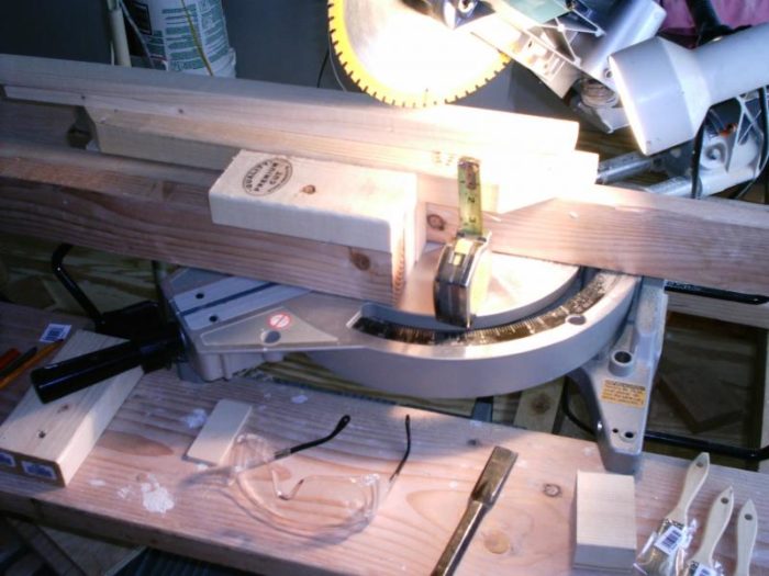

What's the capacity of a 12 " makita compound slide miter? I'm almost thinking that the 10" would do it. I know the 10" will chop 3.5" but later I'll check the clearance up to see what the up " is. Then all you gotta do is flip it and reverse cut for the same. And I know it would be nice to get the 12". I always thought that delta dropped the ball by not making there saw buck into a 12" unit.

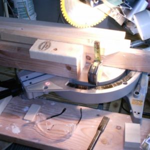

This is My LS1013 with about a clear of 7" to the up. It would get you nice 45s
Sorry about the size of the file but I'm tired of fkn around so this will have to do .
Part of this sending is just me figuring out how to work this stuff. Lets see if I can get this to you it's smaller, I lowered the resolution on the D camera so the file was smaller.
