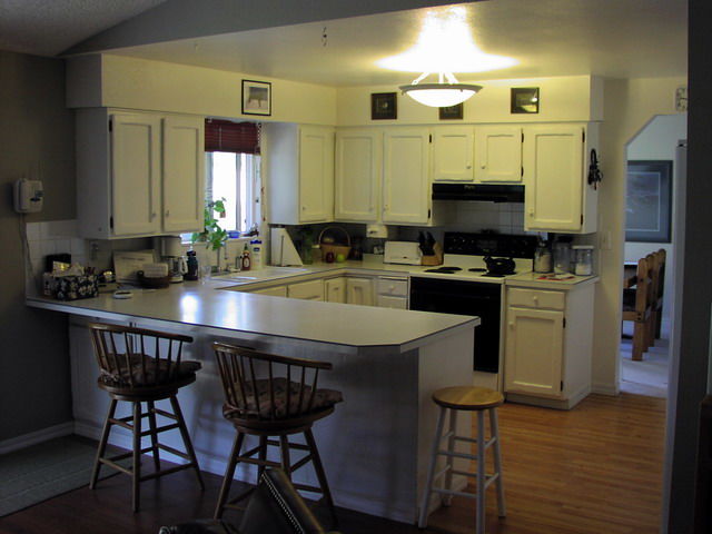

I tell customers it’s gonna get uglier before it gets beautiful.
If you’d asked me about refacing 2 years ago, I’d have told you that it’s just butchering. But it can be done well. Most that I’ve seen use moulding everywhere to cover sins…looks like a mobile home. We aim higher.
Win and I scribe all panels to fit, and get nice crisp outside corners. Hard to tell it’s a reface till one looks inside.
Here’s a job we just finished. Two days to complete.
PJ

      Don, this job was just under $4k. We aren't the cheapest in the area, but do dang good work and offer a five year warranty. We also offer some things that others don't.  Lots of problems can be solved that were there from the git-go. I point these out to people when consulting.
      In this kitchen there was a drawer above the door on the back of pennisula...had all of a 1 1/4" to get your hand in below the overhang. Removed drawer rail and changed to full height door. Hinging on the left sink upper was right and left, changed both to lefts, so you didn't have to reach around door to access. Moved hood shelf up to accomodate micro/hood. Removed unused cutting boards above drawer stacks and installed missing rails. We also do a lot of drawer and guide replacement. Euro guides and melamine boxes are waaaay better than the old monorails that seem to be on almost everything.
      We could actually install new cabinets for not a lot more $, but there are other things to consider. Tops and backsplash, fitting in original footprint because of new flooring and a host of other things. All told, reface usually saves somewhere between 25% and 50% over new.
      Here's another recent job, sounds like just what you're dealing with. Hard to imagine it was the hot ticket at one time! The door on the counter is what we replaced with, I'll get some after pics when I get back to do some other little things they wanted.PJ
