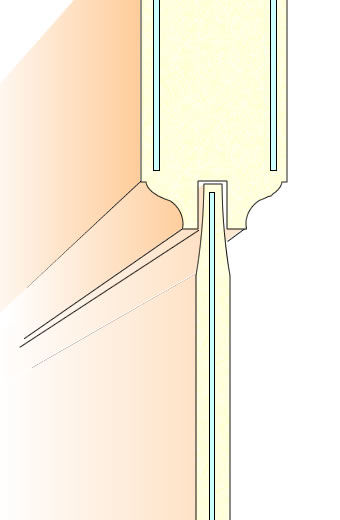

So, about that 6-panel door. No, I can't tell that 10" were removed. I figure you removed it from the middle somehow. Care to share?
-Don
Basically, I just lopped it out right across the middle. The middle panels were originally as tall as the lower panels.
I clamped on a straight-edge (4' level) to get perfect cut's from my circular saw, and made 2 cuts 10" apart, right through the 2 middle panels. Then I slipped the panels out, used a 1/8" slotting bit in my router to cut a slot for a 1/8" thick spline, and glued the panels back together. Then I cut the same slots in the door styles, slipped the panels back into place, and glued the door back together.
I clamped the panels and let them dry overnight, then sanded the seam smooth before doing the door. I also clamped the door and let it dry overnight, sanded those seams, and primed everything before rehanging the door.
Here's a drawing...
Edit: Just thought I should add, this obviously wouldn't work if the doors aren't painted. Also, these doors (I did 3 like this) is in the kid's play room of 3 somewhat rambunctious young-uns. That was about 5 years ago and not a single splined joint cracked yet.
