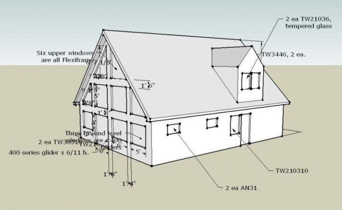

Sketchup is all you need, and it is free. Here is what I did withing a week of downloading my copy. Go also to my posts about kitchen design, titled "another kitchen for comment."
Exteriors, interiors, decks, framing, staircases, etc. Google Sketchup can do it all for me.
