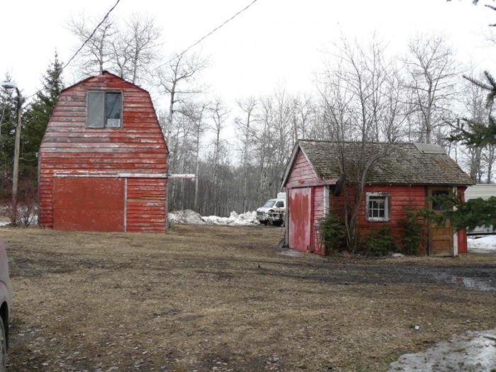

Pic attached in case it helps.
I sthe barn to be removed the gambrel one in the first picture? I only downloaded one, because those are fairly large files.
I ask because if the shed on the right is the one, the low spot with water collecting could be an issue. The barn seems to have drainage away from it though.
If the old were in the center, you could easily leave it right there.

Yup, that's the one (Gambrel Barn),(the smaller shed will be removed too, but has no pad) I think breaking up the old pad and using for fill would be pretty quick and cheap. Thanks for your reply.
