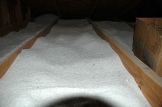

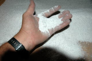

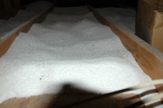

Finaly got it to upload, so here are a couple of pics.
I recognize that...I think someone broke open a beanbag chair up there.
Thanks for the pics.
Have to admit my guess was wrong. That ain't rock wool.
New one on me.
Certainly not vermiculite.
Too much fine dust to be styro.
May indeed be diatomaceous earth. Never heard of it used as insulation in a home before. Would kill any bugs up there though.

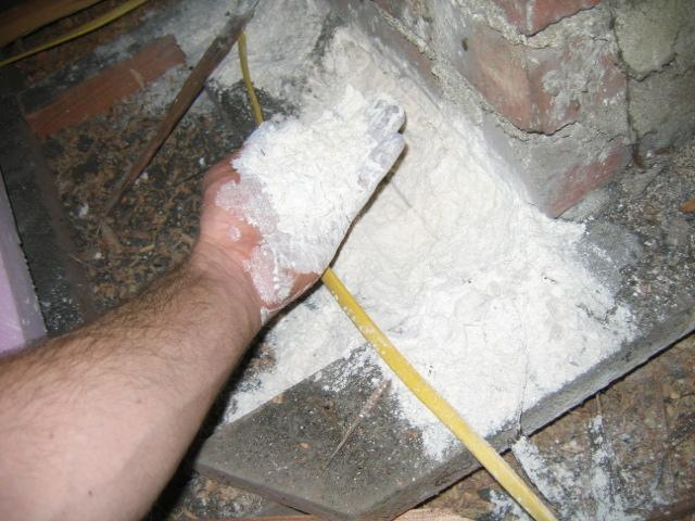

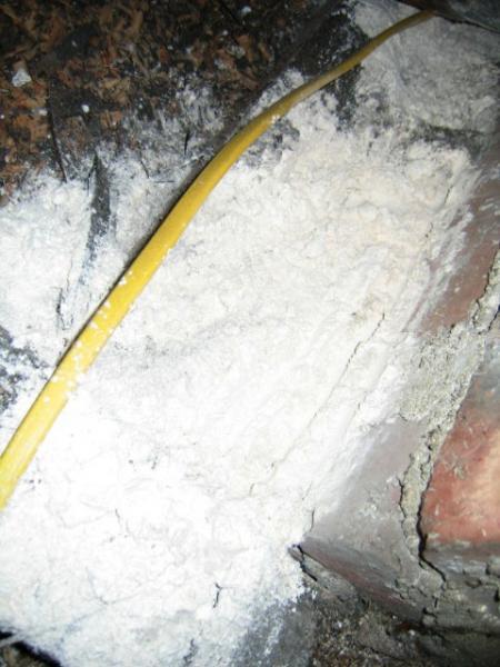

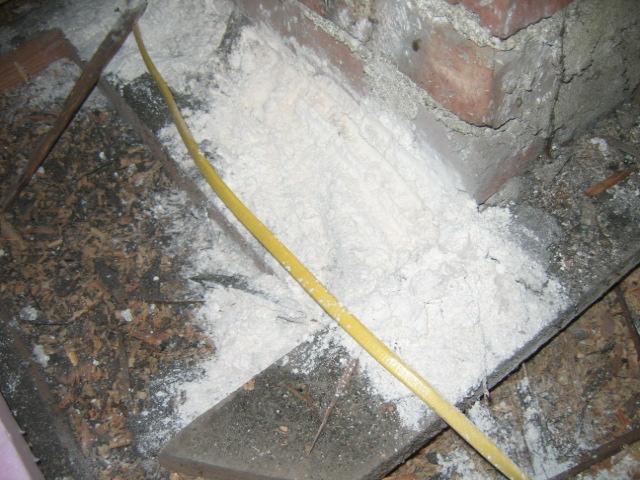

Here's a few pictures of diatomaceous earth from my attic. Your insulation looks less dusty- it's probably coke or sugar, LOL. How dense is it? diatomaceous earth is fluffy, but you wouldn't think it's light enough to be much of a insulator. I'm not sure if all DE is of uniform granularity, so it's possible that it's the same stuff, but I'm not so confident of that anymore.zak

Its not fluffy at all. Its light weight but more granular in consistency, like laundry detergent. I don't think its the same stuff. It could be but it doesn't quite look the same.

http://www.perlite.net/
Sure looks like perlite to me.
Yep, solved.
