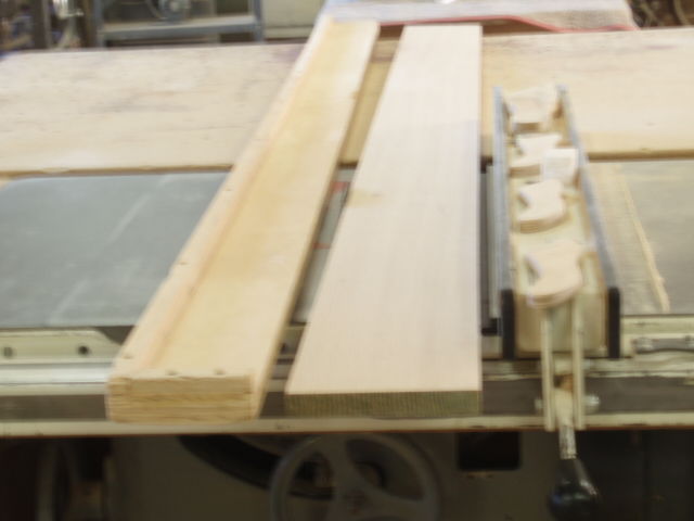

            I have a straight line rip jig that I have used for years. It is made up using a 12' piece of 7/8" Bally Block 4" backsplash. Dead straight and flat.
            A 1-1/2 X 6" cleat is screwed to the tail end for a 'hook'. One rip. Straight edge.
            I have extensions for longer stock.

                  I realize you have it done by now but thought I would share a straight line rip jig I use . No clamping or fastening or laser or power feeder needed.
         I have them made in various lengths to 12' as that is typically the longest I use.
      Just place the board with the crook facing the fence and against the jig run them through the saw , the newly cut edge will be fine for referencing off of .
            regards           dusty

    For this type of work a full length (8') outfeed table is a must.  Use plenty of paste wax on everything to save a great deal of effort and get better results.
    An aluminum C channel is perfect for an extension fence since it clamps onto the existing fence so easily.  A channel about 1/4" thick x 3" to 4" wide and 7' or 8' long works really well when clamped so the far end extends only two feet beyond the blade.  A 6' extension is just to short for most 10' boards and probably doubles the work over a 7' fence.  If everything is full length then perhaps a temp fence that's even longer would save time, altough an 8' fence is quite effective.
    I'll layout all the boards on saw horses, pencil in where each board will be cut (using a cut list) essentially labling each board before it's cut.  Rough cut an extra inch on each end with a hand held framing saw by eye.  There's no sense cutting a good straight end when the sides aren't cleaned up.
    I have a festol rail saw but it is not necessarily the best tool for the job.  Unless you have the larger saw, the cut rate even with an agressive rip blade isn't great.  The saw also works best if the board is perfectly flat and rarely will a rough board planed on two sides be anywhere near flat, expecially on the ends or near knots so the rail will have to be clamped to hold it in place.  Since the rail won't be sitting perfectly flat the cut won't be as true as it could be.
    When the festol saw works well is when the boards are finish thickness planed (not just how they come from the mill) and there is a taper of some sort in the board's shape.
    As for a shooting board and circ saw, the same applies to it.
    Having said that just this week I had some 16' 4/4 2p (planed two sides) rough cut mahogany boards and that's a perfect place for the festol, moving the rail along a fine chalkline.
    Similar results can be had with a fine pencil line and careful freehand cutting with a circ saw and good blade, it's just much slower, requires good focus and will have some extra defects unless you're very careful.  A fine fishing line (80lb spider wire) is about 1/64" wide and makes a fine chalk line, although it's probably better to simply pencil in the line using the string to mark every 4' or so and finish with a straight edge connecting the dots.
    Another variation is to chalk a straight line down one side and quickly run a framing saw down the line, following it up on the table saw.  With badly curved boards longer than the fence extention this is my normal course of action.
    Another option is to have on hand a number of 1/4" plywood rips...I'll tack the plywood rip to the bottom of the board so the brads go into the portion that's discarded so no additional labor is required to unscrew the ply.  It's still slower than just ripping to length and running through the tablesaw.
    Good ripping!
