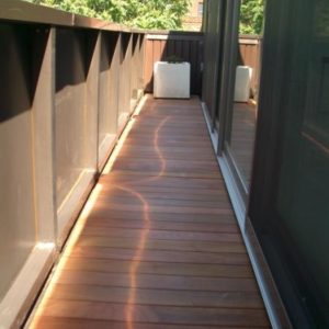

  4. reinvent | Aug 29, 2008 02:22am | #11
    I would put it on sleepers and screw from the underside with SS screws. Then it will breath and you can remove it if you need to do work on the roof.

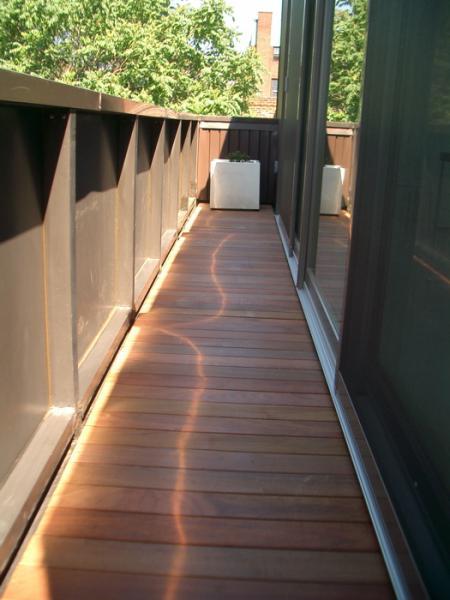

      1. reinvent | Aug 29, 2008 02:53am | #14
        Whats the pitch, 1/4" to the ft ? If so I would put the Ipe right on the roof with sleepers like I said. The pic I posted was done this way on a rubber roof with about that pitch (tho you can not tell with that small a deck).

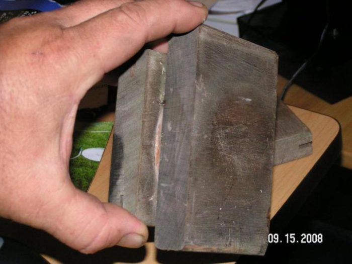

  6. Boats234 | Sep 16, 2008 04:44am | #27
    PL Premium just doesn't cut it. Use 3M 5200 (preferred) or 4200.
    I've never had Ipe cup to a point where it would hold water no matter what method was used.
    The method I used was 5200 and 18g staple or brad toenailed just to hold in place while the 5200 set up.
    I would krinkle every fifth brad, but they were easy to pull out.
    I used tigerclaw fasteners every 3rd or 4th joist depending on the length of my ipe board.
    The reason for even attempting this the 1st time was due to shortage of tigerclaw clips.

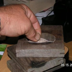

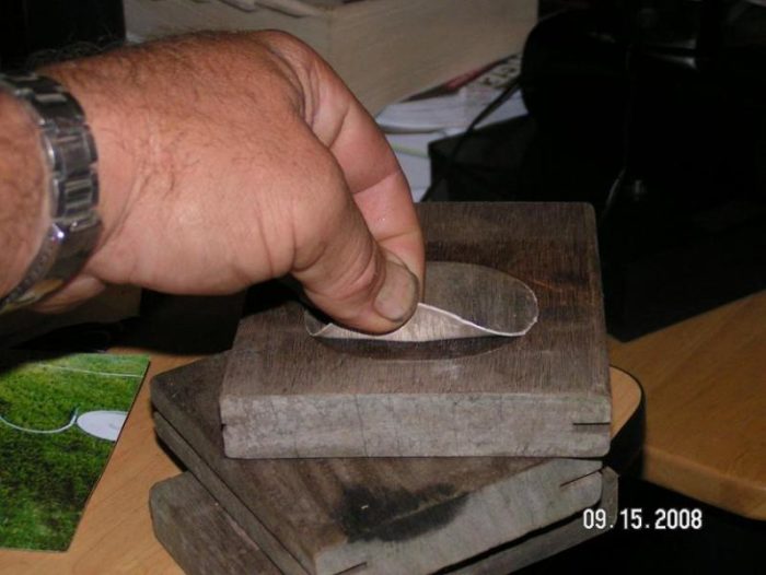

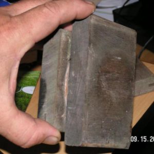

    I ran out of 5200 one day and used PL Premium to finish up the day-- about 6-8 boards. I glued up 3 scraps of ipe using 5200 on 1 side and PL on the other. I forgot about this test piece until a few weeks ago when I was prepping for the hurricane.
    Anyway I found my test piece (pics below) and put it to the test. The PL side came apart without too much tugging, while the 5200 side is stuck better then a screwdriver can do damage to.
    The PL is still pliable, but does not have a good bond.
    Both methods survived the eye of Gustav last week, but I'm sticking to 5200 for all outdoor projects.
