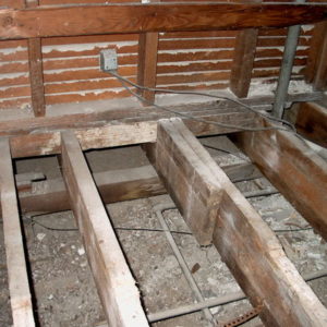

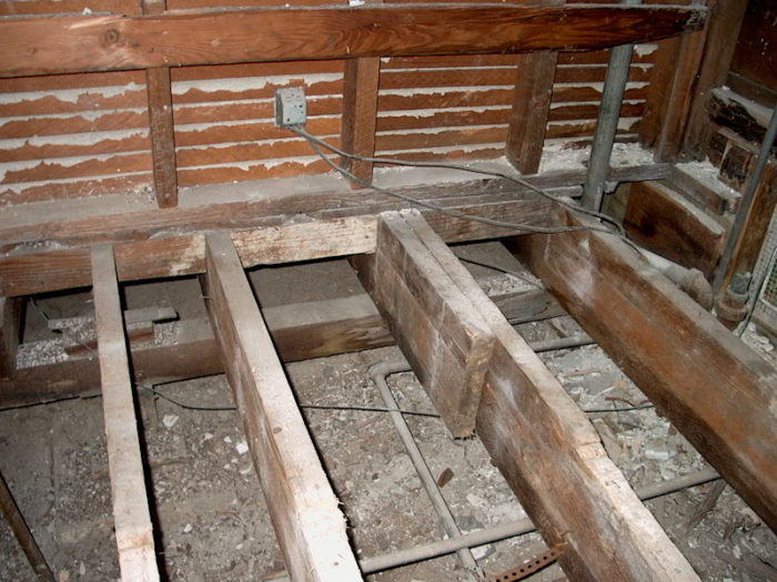

Hello everyone,
I recently, demo-ed the floor in my bathroom.  This was quite a task.  The home was built in the 1920’s and the tile and mortar bed were well built.
The tile and mortar bed covered 50% of the floor.  So, the joist were cut to lower the floor for the mortar bed.  Was this a common building practice?
Also, I plan to go with tile in the remodel.  So, I will need to lower the floor ( the other 50% ) to be flush with the hallway, which is wood.  Is this a common practice in a remodel?
Any insights will be appreciated.
Drake

      This is a small bathroom, 5 by 7.  In reexamining the floor joist, 80% have been lowered to accomodate the mortar bed.  A bathtub sat on the other 20% of the floor.  It looks like an inch was removed from the joist.
      My goal is lto level the bathroom floor with the hallway floor.  I don't want  the finished bathroom floor to sit an .5 inch above the hallway floor.
      Would heads roll, if I lower the the remaining 20% of joist and sister new joist to the old.
      Drake

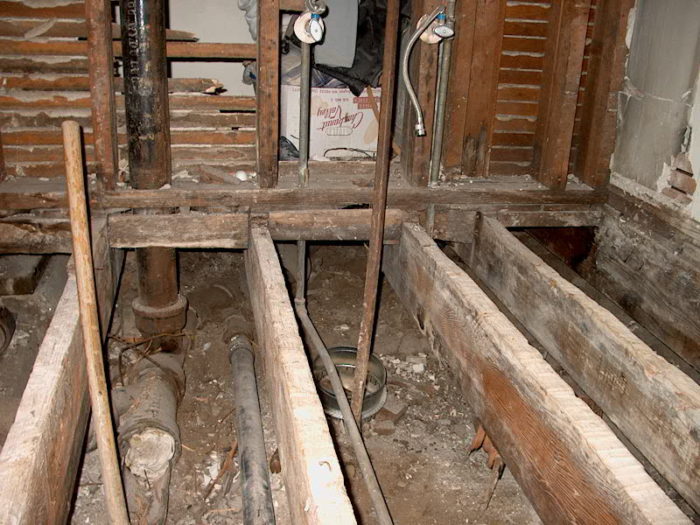

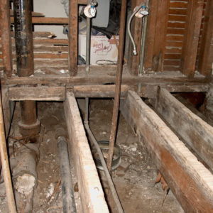

      2. Geoffrey | Nov 27, 2006 12:15am | #8
        In your pic, do the joists run to a bearing point that is beyond the plumbing wall in the pic?  In order for sister joists to have any efectiveness they must bear at both ends, otherwise you are just adding to the load and not adding any strength. Solid blocking(bridging) down the mid-span would also help stiffen the floor. What's the height difference between the top of the existing cut-down joist and the finish floor in the hallway?
                             Geoff
        1. phixit10 | Nov 27, 2006 12:50am | #9
          Hello Geoff & Forum
          Wow!  An important point.
          At one end, I have an accessible bearing point.  Yet at the other end I do not.  So, sister/ing joist would not be effective.  It would only add to the load.  Unless I built another bearing point.
          The height difference between the cut joist and the floor looks to be about 2 inches.
          Drake
          1. andy_engel | Nov 27, 2006 01:25am | #10
            It looks like access to the crawlspace there is pretty difficult. One thing you might consider while it's open is to spread out a vapor barrier on the dirt.
            While sistering joists that don't reach both supports won't add strength, it's likely an easy way to level up that framing. The sisters don't need to be the full depth of the originals - 2 x4s would probably work. And the weight they'd add to the system is really inconsequential compared to the weight of the mud floor you've removed.Andy
