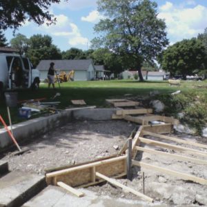

  1. RalphWicklund | Oct 13, 2008 02:52pm | #1

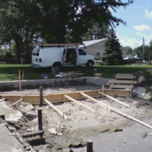

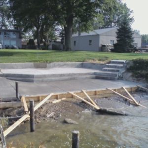

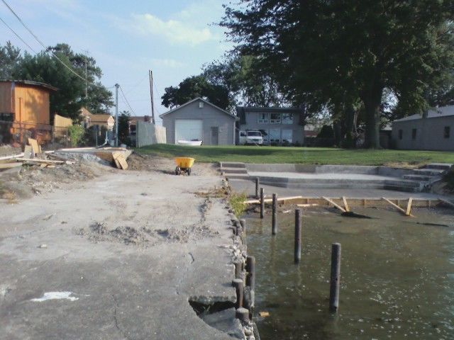

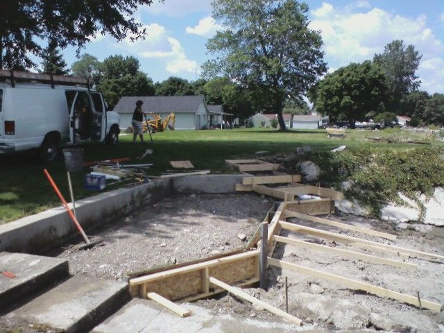

    See if this meets your needs.
    It's not the most fancy of formwork but it served the purpose and the steps are good.
    Basically a floating box on a box with bracing. More bracing was added after the pic was taken.
    Use a low slump mix and your palm sander to vibrate the sides of the form to minimize the voids that will occur.
    Edited 10/13/2008 7:53 am ET by RalphWicklund

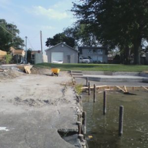

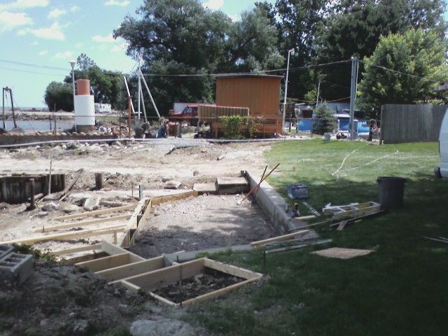

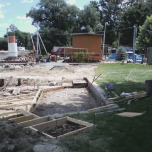

  2. JHOLE | Oct 13, 2008 03:21pm | #2
    What type of soil are you working with?

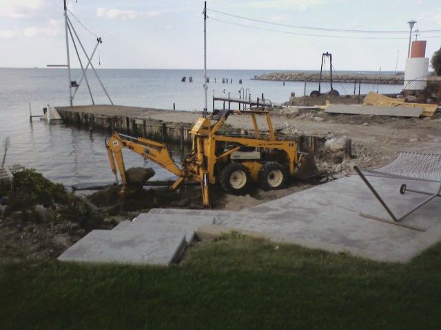

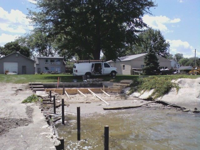

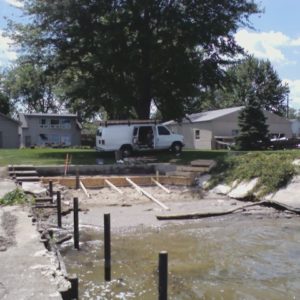

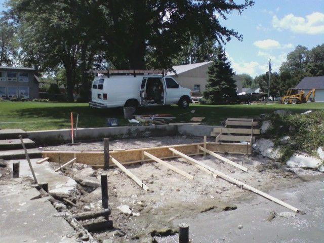

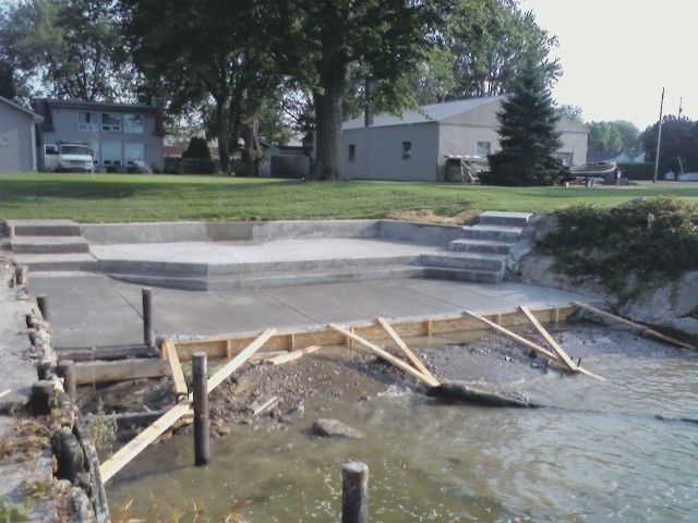

    This was about 8m long;
    Fwiw, on second - lower section - used long jet rods, with 2x8, poured, waited, pulled, filled rod holes - for small step.

      1. JHOLE | Oct 15, 2008 02:47pm | #5
        The round metal concrete form stakes.
        Totally worth the money to have, for all kinds of uses, though they aint cheap.Remodeling Contractor just on the other side of the Glass City

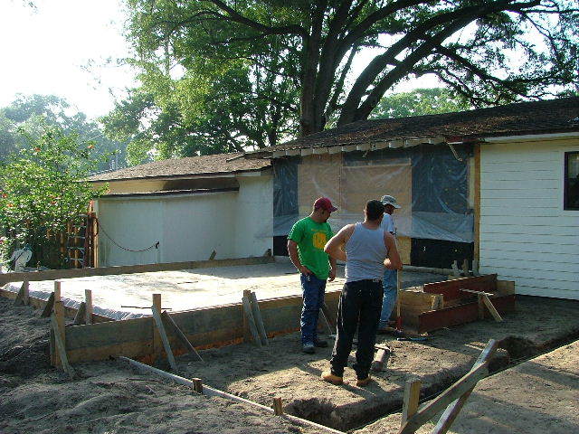

  3. sungod | Oct 15, 2008 01:30am | #3
    Nail a 2 X 4 board to connect the tops of the riser form board to stiffen them. Wider steps require a "W" patern to the bracing. I cover the riser forms in 10 mil plastic to give the risers a slick finish.
