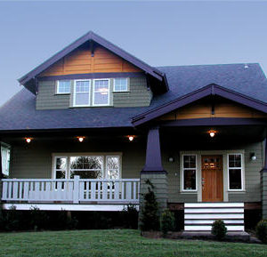

Looking at building a new home, and the wife and I love old bungalow look story and half. Our lot is basically flat and we would not be able to have much walkout if any. Dont want slab or crawl. The style of house we are looking at is elevated so that about 5-6 steps up to front porch. Is it possible or plausible to basically build house on slab with one foundation wall in front and build grade slightly at front of house. I would then tuck side entry garage in “basement”. seems to me that this could be a money saver? Your thoughts are welcome
