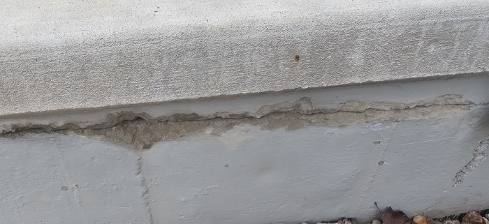

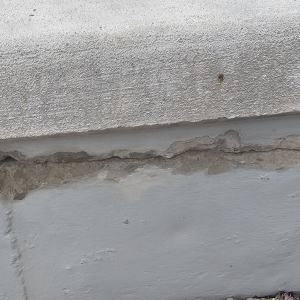

In Climate zone 5, eastern. Got some delamination, chipping going on for both sides of the porch slab, foundation joint. We had one of the coldest freeze and thaw cycles in 2024, 2025. It doesn’t seem to be getting any worse, but it looks ugly.
In the fall of 2024, I wire brushed it. I then got thin aluminum stock and stuck it in the joint so I can mortar both sides. I used Portland and mason sand, and I also tried hydraulic cement. It’s just too thin in some areas. It just isn’t strong enough and falls out but I thought it wouldn’t hurt to try it. When it rains or snows the porch gets soaked on this side, so that isn’t helping either as the wind blows the rain into this side of house.
What can be done about this? Epoxy injection? urethane sealant?
I was also thinking about grinding a very slight chamfer on the chips to feather it out. I also thought about widening the horizontal joint by cutting a nice clean 1/8”-3/16” slot in that transition joint and filling it with sealant.
My last question is should I sandblast the drylok off ?  There is drylok paint on foundation above grade only. Basement interior is not painted.

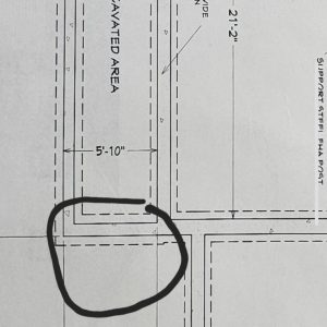

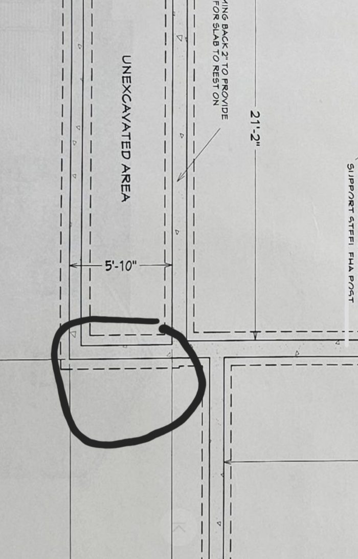

      Look at the blueprint attached. Look at the dimension 21'-2". That's where the full basement is. The problem area is "Unexcavated Area" There is nothing but stone and backfill under the porch slab.The cracking area is circled. That's what I'm trying to solve. How to go about it. I can worry about Aesthetics when this is solved.
    ct_yankee | May 18, 2025 12:45pm | #3
    The concrete above the crack is the slab concrete, and below is the wall placement concrete. The very top of the wall placement is usually crappy concrete if care was not exercised as it was finished (i.e. there was no proper finishing).
    Best course of action: Rout out the crack widening it to at least 1/2" or more taking most of it off the wall portion. Find a good repair mortar, follow the manufacturer's instructions to the letter, fill the routed out groove, cure the repair mortar properly and you should be good. Be sure to dampening the concrete before applying any mortar. Concrete should be DAMP, not dripping with water.
