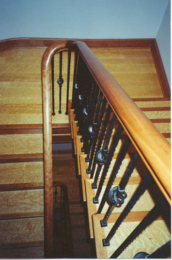

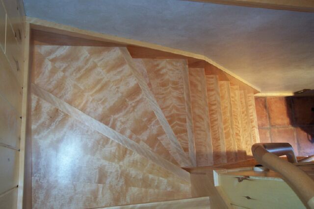

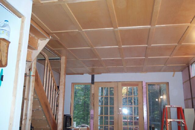

Frame & Panel ceiling made of yellow birch. Winder stairs curly yellow birch. This is a super short steep staircase, the whole stair system, not counting the landing fits into a 4′ x8′ space. It’s surprisingly comfortable to use. Stairs at the narrow point are 32 inches wide, the only reason they passed code was the walkout basement had a separate door to the outside. All other aspects of the stair meet code.
Stair treads and stringers are bookmatched 1/8 thick curly yellow birch veneer all other parts are solid lumber.
Handrail is continuous, climbs and wraps around the winder corner.

    photo of winder treads

      completed stairs, top view and side view.

        photo of finished ceiling, aspen paneled wall and door trim. I think the spots are the ghosts that took all my pencils.

      3. Piffin | Nov 20, 2002 02:27am | #8
        Some of us would consider it sinful to WALK on those stair treads!!!.
        "The first rule is to keep an untroubled spirit. The second is to look things in the face and know them for what they are." --Marcus Aurelius
        1. CAGIV | Nov 20, 2002 07:44am | #9
          Very beautiful stairs and ceiling, and I agree, not sure I would walk on those stairs, or let a dog or cat with claws run up and down them or kids, brings a new meaning to leave your shoes off at the door.
          1. Justus | Nov 20, 2002 05:39pm | #10
            I'm with Piffin and Cag, thoes stairs are for socks only! Very very nice work, you may want to think about doing this for a living : )

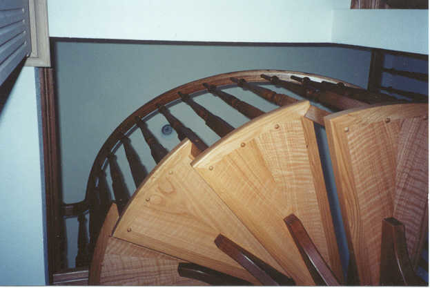

            Figured wood treads is kind of my trademark
            Photo of birdseye/ cherry combo
            Photo of curly oak tread

            Just wondering if the stairs were solid wood, or veneer, and if the they are veneer how many cotes and what do you use to finish them?
          4. Armin110 | Nov 21, 2002 03:48am | #14
            The treads are 1/8 in thick veneer laminated on a 1 in thick baltic birch core, edged with a 2 in x 1 1/4 noesing. I use 1/8 veneer because I can resaw 4 laminates from a board giving me 8 book matched treads from one killer 8 ft board. In most cases I can build all the treads from 2 matched boards. The stringers are done the same way, risers are usually plain 1/8 veneer or if the center gets carpeted I'll sometimes use veneer plywood.
            The finish is one coat of oil based polyurthane to bring out the grain followed by two coats of waterbased floor finish for durability.
