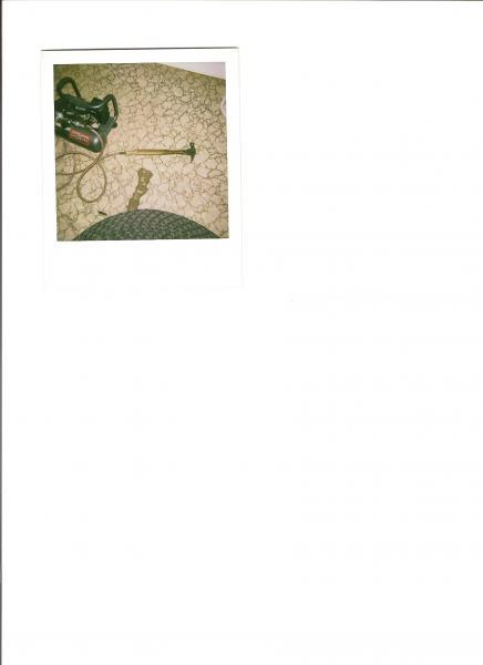

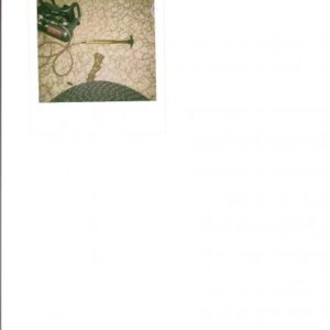

    3. doodabug | Oct 09, 2005 12:29am | #37
      A good hammer.
        dieselpig | Oct 09, 2005 01:41am | #38
        Sweeeet!
        Hey, how do you like that little Senco compressor?  That's the lil' one, right?  Will it run a framing nailer for light punch-out type work?  I've been toying between one of those compressors or a Paslode cordless for punch-out.  The main reason why I haven't pulled the trigger on the Paslode cordless (no pun intended) is that they use clipped head nails... and I don't.  Seems I have enough nails to keep track of and stock as it is without adding another into the mix.
        1. doodabug | Oct 09, 2005 03:54am | #39
          I have nailed 1x's to joists with it and a stud or two with it. Best suited for brad nailer and no good for stapling luan. I bought it for a third floor trim out. Probably not a good buy, just a little tooooo small.
