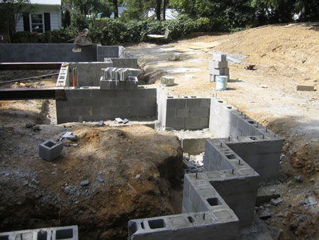

How often do you guys waterproof the inside of a crawl space space?
Our builder is installing a french drain on the OUTSIDE of the foundation, as well as a new drain in the yard itself.
A friend of a friend who owns a waterproofing company suggested that the inside of the space should get a drainage system as well.
Do crawl spaces often flood? Is this necessary?

Your block foundation would be a greater risk of water permeating through than with concrete foundation. I think on consideration for the small extra cost that a crawl space floor drain would be a good thing. Hopefully there is enough fall in the existing house drainage system and there would be no need for a sump and pump.
If the exterior drain is done well, the interior drain is redundant.
