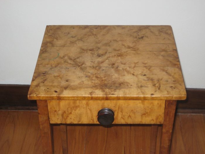

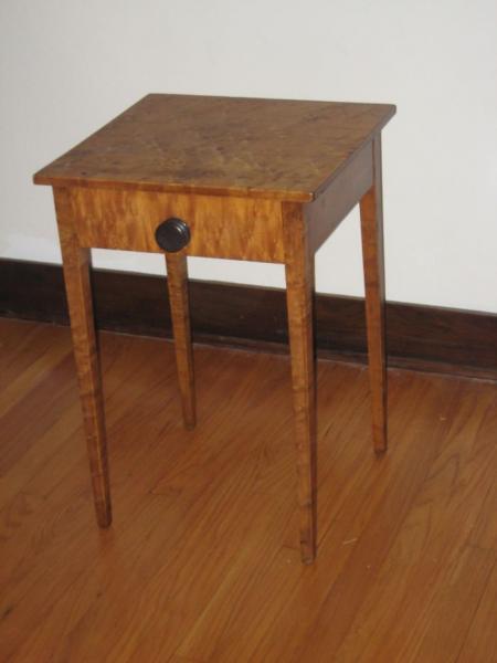

I bought this figured maple Hepplewhite stand at an auction, it was painted silver and blue, really nice I tell ya!
The top was so warped that I didnt believe that I could do anything with it. I took it off and did the old lay it in the sun on wet grass trick. Forgot about it for about three hours in the hot part of the day, came outside and there it was, warped the other way - but worse! I played around with it for a few days before I got it back to flat but I really watch things when I put them in the sun now.
It had the cracks in the top before my screw up but luckily for me they didnt seam to get any worse, didnt break at any of them.
Soon as I got it flat I Frenchy'd both sides with the hope that it'd stay flat, been that way for 15 years now so I think I'm out of the woods. Probably helps that its old growth wood.

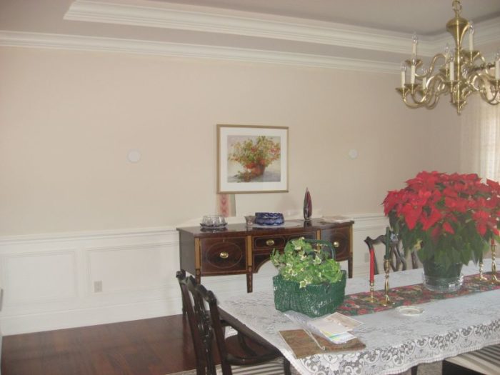

I believe all of it was 21st century. They had some cool reproduction furniture that was made by Stickley, like a pair of really cool federal Hepplewhite sideboards, Cherry and some real nice inlay. At first glance I thought they were period but after looking at them closer I realized that they were just well done repros.

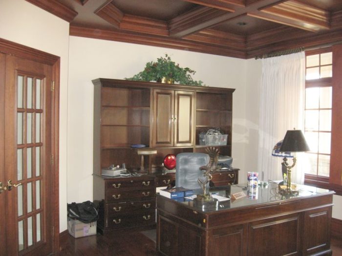

Here is a couple pictures of the desk and credenza that I believe belonged to one of the Stickleys themselves. hell for all I know they were made of popular, so damn dark! Furniture by Stickley, coffered ceilings by Doug!
The other pic is of the federal sideboard, not a real good picture but not your typical Stickley either.

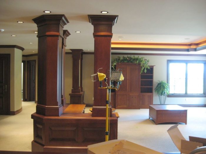

Then I found another pic of a house that we did right after this one(above) and they also had some cherry Stickley in their basement. This was all new, saw it come in on the furniture truck. Damn, who left that lamp there, that dont fit the decor! Also furniture by Stickley, lally column wraps by Doug.
