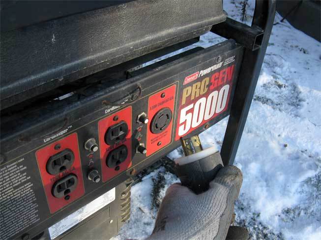

  8. Scott | Dec 22, 2008 05:12am | #20
    What renosteinke said.
    You can buy a transfer switch panel, receptacles, and cord kit. It works well, improves safety by a huge margin, and lets you set up in a jiffy when the power goes off. It also avoids drafts from impromptu holes punched through a wall.
    Let me know if pics would help, I've got such a setup. Cost less than $100 for the whole thing.

      1. Scott | Dec 22, 2008 08:19pm | #32
        I'll snap some today and post to this thread.Scott.

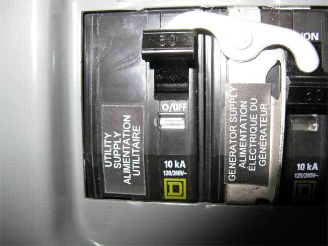

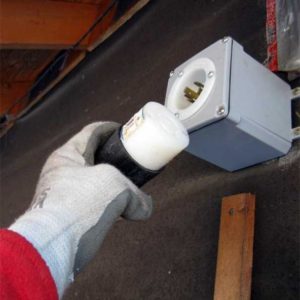

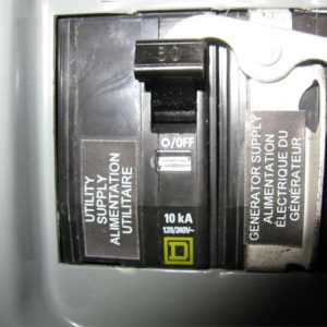

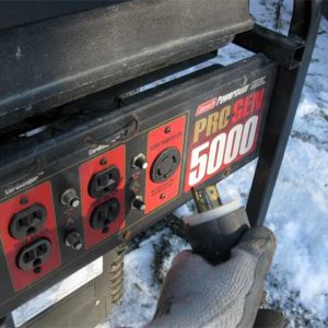

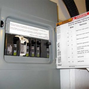

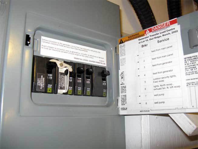

      2. Scott | Dec 22, 2008 11:21pm | #35
        Here's some pics.
        This is the male connection to the generator:
        Female connection to the side of the outbuilding (our pumphouse). Nice siding, huh?
        This is the transfer panel directly through the wall. This transfers electricity between four breakers on the main service panel to four breakers on this panel.
        Here's a closeup of the transfer switch.
        Scott.

        1. marv | Dec 23, 2008 12:37am | #36
          Transfer switch is the way to go.  Set up the furnace on one circuit and you'll be good to go.  It prevents electricity from going back into the grid and zapping a worker on the utility pole.You get out of life what you put into it......minus taxes.
