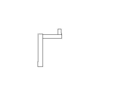

  1. Splinky | Feb 14, 2006 03:54pm | #1
    Hold the other end up with a 1x3 with a small block screwed to the end. As a matter of fact, make 2 or 3 of these things and hold the entire thing up while you nail it off.
    It's magic!
    David H. "Splinky" Polston
    Founder of Sawdust, Norfolk, Virginia
    1. Splinky | Feb 14, 2006 04:10pm | #2
      I need to clarify... use a long 1x3. I use one a foot longer than my ceiling is tall. The scrap is screwed in an "L" on the top so that the crown will rest on the "shelf" you create by leaning the 1x3 against the wall.(It was bugging me that I didn't explain that... now I can relax and go beat the heck out of my day!)David H. "Splinky" Polston

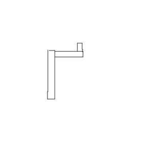

  2. Dave45 | Feb 14, 2006 05:32pm | #3
    I use these.
    1. harrisdog43 | Feb 14, 2006 06:02pm | #5
      Looks good D45; I like it!!!
      1. Dave45 | Feb 14, 2006 07:11pm | #6
        The trick is to put them as high as you can and still "roll" the piece of crown into the cradles.  Then. you just work your way across.  In case you didn't notice, those were set up to work left to right (I'm a lefty).  I won't guarantee they will even work for a righty - lol.
        You'll have a few nail or screw holes in the walls but that's easy to fix.

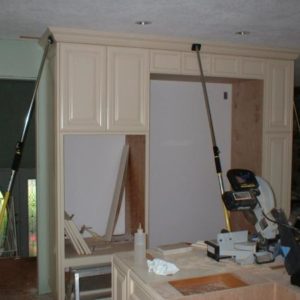

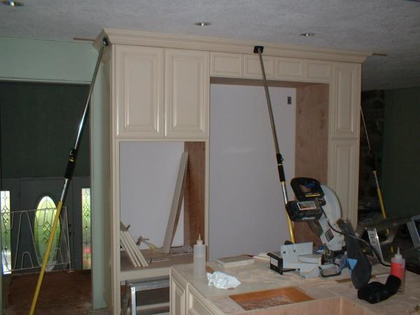

  8. cabman | Feb 15, 2006 06:39am | #19
    Here are the ones I like, they extend out to 11'.

    1. nikkiwood | Feb 15, 2006 05:07pm | #23
      those are Third Hands (from Fast Cap), right?http://www.fastcap.com/prod2.asp?page=3rdhand********************************************************
      "It is what we learn after we think we know it all, that counts."
      John Wooden 1910-
      1. cabman | Feb 16, 2006 06:16am | #29
        These ones are Task, Chinese I think .
         I have a couple of those Third Hands though, they are very nice.
