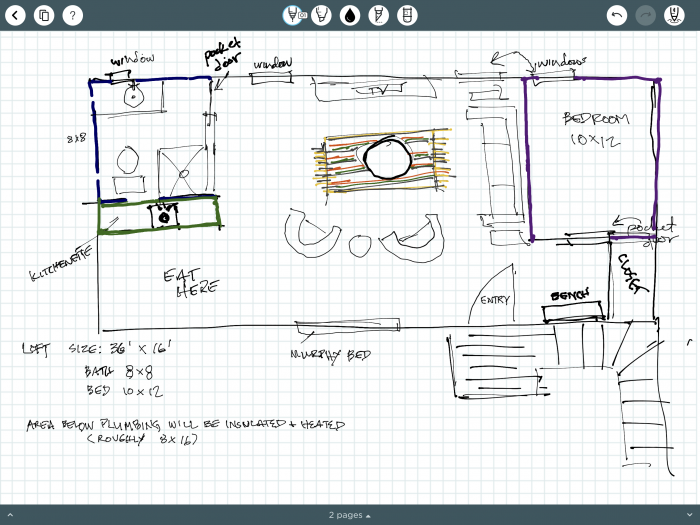

Hello all,
I am building a pole barn garage with a 575 sf (16×36) loft apartment above it in northern MI. Cold. It will be used all year as the cottage for a few years then later as a guest house when we build a cottage. It will have 1 small bedroom, a 3/4 bath and the rest open.
I think it will have minimal use in winter when it is a guest house because I don’t expect overflowing winter guests when it is 5-below!
I am not sure how to heat it. Electric or propane, no natural gas.  Energy cost is a consideration.
I believe I will need to have a conditioned room under the loft for water pipes to go through to underground so they do not freeze, so that space (roughly 8×16, directly under the only plumbing in the loft) also needs to be kept above freezing.
I was thinking air source mini-split to also get some cooling upstairs but the local builder said it will underperform in the cold and risk going below 40 degrees when we are not using it. Also said it will take forever to heat up so when we come for a winter weekend it take hours to get to 65 degrees. Additionally, Mini split does not heat the mechanical space below.
What solutions do you think are best and most cost effective for heating and hot water?
I like the idea of solar but the area is wooded and the nearest clearing for a small ground array is about 250-300 ft away.
Thank you!
Jim
