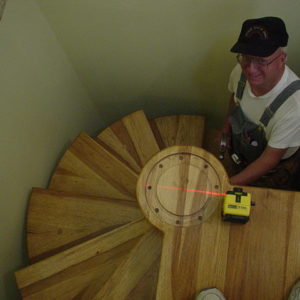

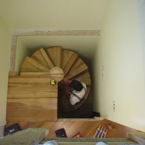

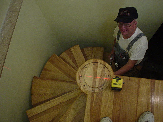

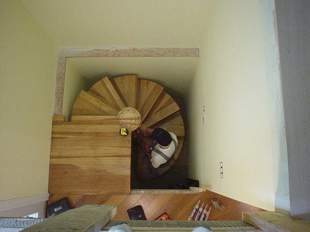

Anyway…got to pay the bills so I am busy building and installing a two story hickory spiral.  These are the basement to main level photos.  Next week I will be working on the upper story.

    Stan, Looks like quite a project, hope to see the completed job.  What is the laser being used for?

      Mike:    I had the laser projecting a vertical plane of light that I was using to make certain the second story landing was exactly plumb up from the first story.  I squared the beam up and then was just able to easily measure this plane of light upstairs and make my cut measurements.
