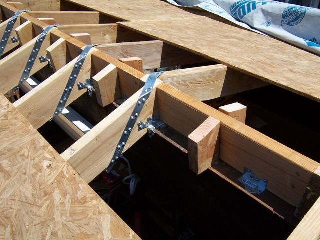

Oh, yes they will:View ImageThose are all McFeelys #10 1.5" round washer heads, and all approved by the head of the Building inspectors here. (and No I would not have cut the rafters the way I did if I did it again. I was just repeating the mistake of the previous roof framer).
