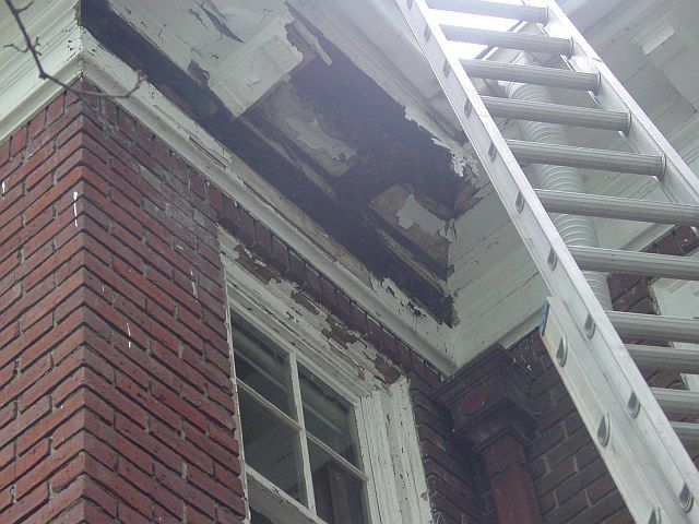

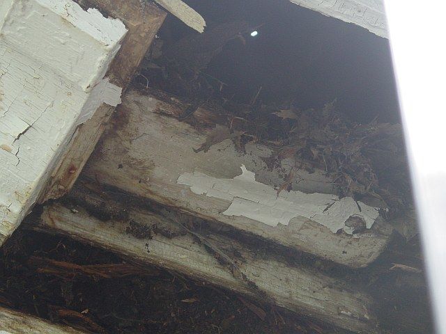

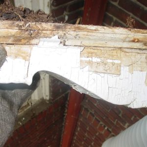

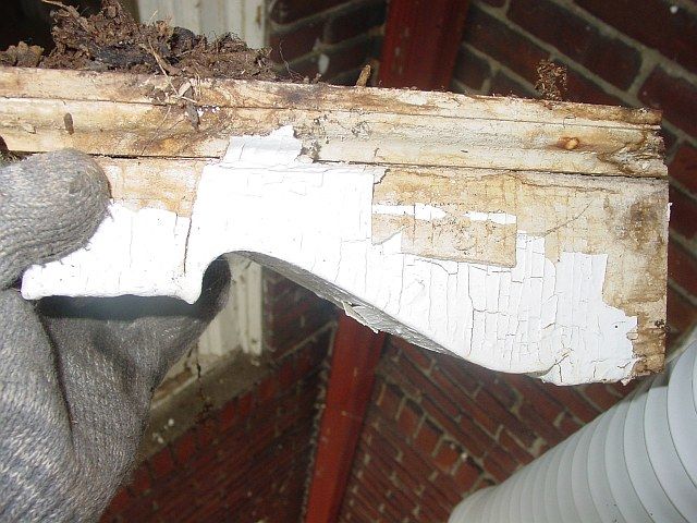

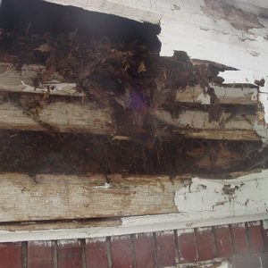

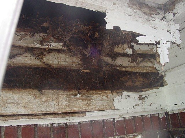

How long do you suppose this roof has leaked to make this much damage.
House is now for sale so a H I might pick up on this problem !!

    Is that your dryer hose diverting the leader water or has it been there for a while?
  2. stevent1 | Aug 26, 2008 02:10am | #2
    Walter,
    10 years or longer. I am also amazed HOs do not maintain or even look at their property.
    I looked at a house last week in the Historic district of ColGa. Facia, frieze, raised panel soffit and brackets are shot. Not as bad as what you show, but all need replaced. The home I looked at has 4' between the adjoining houses. The HO's decided to get another bid when I explained/quoted the custom staging.
     Will you bid the carpentry as well as well?
    Chuck S
    1. theslateman | Aug 26, 2008 02:36am | #4
      Chuck,
      Yes, this is a great little project for a one man operation. Start by installing new valleys and sections of apron so I can gain some slates.
      Then move down and rebuild the eaves.
      One 18' tower is all the staging required for this work.  Half a mile towards downtown from the gutter reline job.
      Walter

          Is that  an old downspout in the corner, where did that feed from?
          The drier vent hose is a nice touch too.
          Looks like a fall through the roof job if you're not careful where you step?

          Walt, You should show everyone the rest of the damage to the building from postponing this repair job. Andrew
          1. theslateman | Oct 04, 2008 01:39pm | #10
            Andrew,
            Once I get set up I'll take more pictures of what this leak did to the windows and trim on that whole wall.
            Dump trailer will be emptied Mon.
            We can start on the back though since we can't reach the trailer from there anyway.
            Walter
