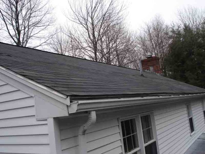

I’m stumped on this one.  Yesterday I looked at a two story house where the owner, among other things, noted buckling roof shingles and black stains under the roof sheathing.
Easy, I figured.  Not enough insulation and/or air sealing in the insulated attic floor, and probably no soffit or ridge vents.
Well, there are propa-vents, leading to vented vinyl soffits, and there is a properly installed ridge vent.  The attic floor had additional joists to raise the floor level enough for 8-10″ of blown fiberglass on top of the original 6-8″ of fiberglass batts.  There is probably not enough air-sealing, and an insulated air duct runs through the space, but it looked about as well done as I’ve seen.
The owner had a fan installed in a gable end vent, wired to a humidistat set to turn the fan on when the humidity reached 35° or so.
So the question is, why is the roof sheathing black, and why are the shingles buckling?

    1. mike_maines | Apr 25, 2009 01:38am | #2
      Bob, to keep things short I left out:
      Very nice dry full basement.
      South side (pictured) and north side appear to have equal amounts of mold/mildew.  Kitchen is two floors below.
      I'll check on waste vents, didn't think of that one, but the quality of construction looked pretty good up there so I'd be surprised if that was the culprit.
      This is a service project for past clients we did a kitchen and bathroom addition for.  They're a retired couple, own the house and aren't going anywhere.  They just want things fixed, and fixed right.  The buckling shingles look weird to me and the roofer (high-end) who looked at another part of the project with me.
      You know, you reminded me that after we did the kitchen ten years ago, we remodeled their master bath on the second floor about five years ago.  I'll check that we didn't mess up the vent fan there.
      Have you seen shingles fail prematurely like this, about ten years into what look like 25yr 3-tabs?  Could interior moisture contribute to shingle failure?  I suppose if the plywood is saturated it could have delaminated.  I'll check on that too.

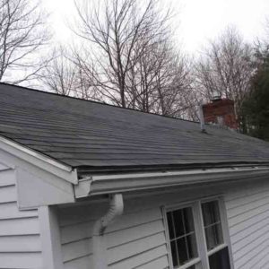

        Same basic problem--buckling and cupping 25-year 3-tabs after 9 years--but only over one small area of the roof, and it's the porch roof at that (no heated space under it).
        We figure it was a bad lot of shingles; I checked my bills for that job and found we had two batches delivered because of a screw-up in ordering.

        2. mike_maines | May 04, 2009 04:08pm | #13
          That looks familiar.  That's only 9 years old?  Wow.
            Dinosaur | May 05, 2009 03:48am | #19
            Yeah, I did that job in 2000. It actually looks worse than some parts of a job I did in 95 using el-cheapo 10-year 3-tabs. Weird. The affected area is only about 75-100 sq. ft. You can see by the photo that the rest of the roof is in perfect shape.
