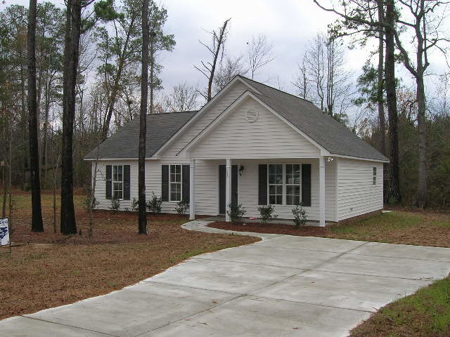

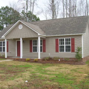

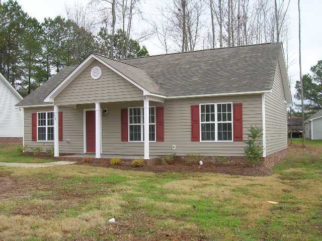

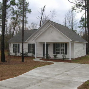

        Hate to admit it but I built some economy houses last year for ~$60 a ft +-, excluding land.  See attached pics.  Just because a house is minimal in design though doesn't necessarily mean that it cannot have reasonably good quality of workmanship on the stuff that is installed.  Really, there is nothing "wrong" with the houses and I told my wife that if we could be satisfied with something like that we would never have to work another day in our lives... I probably could have gotten the price down a few $ a sq ft if I had not done some stuff like unrequired hurricane clips, sealing tape around windows, solid wood sheathing on all ext walls, sill seal under ext walls, R-15 insulation (R-13 is min), and done textured ceilings, 20 yr shingles and cheaper cabinets.  Probably could have even knocked off a few more $ if I had of hired the absolute cheapest subs I could find and then beat them down on their price some more (who cares how things come out).  The homes were around 1300 sq ft - if we had done some of the above and increased the sq footage to around 1800, 2 story, with still 2 baths and the same kitchen or maybe 2200 sq ft 2.5 baths I think I could have easily hit $50, so I'm thinking that maybe Centex, Pulte, etc, might be able to do $40 (excluding land) on their "no frills" products.
        Edited 4/4/2006 7:37 am ET by Matt

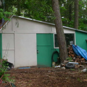

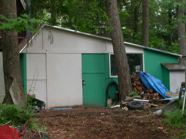

        1. junkhound | Apr 04, 2006 04:05pm | #15
          Like the waterfront property philarenewal posted, under $1 sq ft and livable is possible in areas with no permitting requirements. That leaves a 'reasonable' $39/sq ft to the various NO govmt agencies for the permits, etc, so the $40 is probably do-able.
          Attachment = 1/2 concrete floor, 1/2 painted plywood floor, roll roofing, free reclaimed insul glass windows, wood heat, all DIY labor; garage sale electrical and plumbing equipment, free paint, etc. - one grandson says I can live in it when Grandma dies and he can live in our house*.  Permit costs not included.
          Overall cost out of pocket for attachment (in 1976) less than $0.80 per sq ft (not incl. land, the land under it which goes for over $12 sq ft here now). Of that 80 cents, 50 cents was cement for concrete and the roll roofing ingredients.
          *similar 'old folks spreads' in the area now get sold by heirs, every existing building bulldozed, and 8 per acre  $400K 'shacks**' put up at about $200 sq ft, incl land.
          **or cheap McMansions, whatever.
          dieselpig | Apr 04, 2006 04:32pm | #17
          Matt,
          Nothing wrong with those houses.  I'd actually love to frame a few of those, I think it'd be refreshing.  Blast 'em out, not too many details to get hung up on.  I bet if you had a bunch of them to do, I could get the framing labor # down to peanuts because of the simplicity and repitition.  I'd cut patterns for everything in there and put the crew on auto-pilot.
          (I'd even throw in the sill-seal installation for nothing)  ;)View Image

            Matt | Apr 05, 2006 04:53am | #28
            >> $30,000 to $50,000........
            At least that's what they say. I'm sure that's with a large markup. The property was just a field with a ton of Mesquite..... <<
            I'm guessing these lots you are talking about have streets, water, sewer and power?
            On another project I'm involved in, 20 acres was bought for roughly for a quarter mil $ - it could be called a field with a ton of mesquitos.  It is being broken to roughly 86 lots making the initial "lot cost"  $2900 /ea.  The development costs to make it into a subdivision will be roughly 2mil.  Now our mosquito field costs $26,000 for each lot... And, yea, the lot costs will be marked up - since I'll make a wild guess the developer is in it to make money - so the finished lot cost to the builder will be about $30k.  And yes, the builder will probably mark that up to maybe $35k.  It's just so weird the way people get into this stuff to make money...

            Matt | Apr 05, 2006 04:33am | #27
            The sale prices (land inc) for the houses pictured are aprox $74 a sq ft. - very low profit margin.
