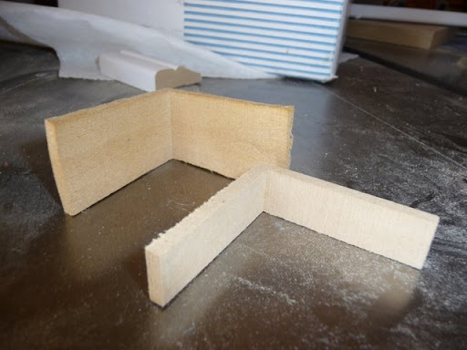

I used a scrap of 5/8″ MDF to set a thermometer on while calibrating it in a steamer. The resultant expansion surprised me.
An unsteamed piece of scrap is shown for comparison.
First, the amount of expansion was way more than I’d expected.
Second, the expansion was all in one dimension, thickness, and none to width or length.
Thickness exactly doubled (at the ends where the weight of the thermometer did not inhibit movement)while length and width directions of the original board were unchanged.

    Not an April Fool's joke...I can see the picture of the two scraps of mdf placed on what appears to be the top of a table saw.
    Question: If I build a single story house in Florida with mdf and the weather becomes steamy, will I end up with a two story house, or just cathedral ceilings? :-)

        I don't think that's the problem necessarily. I use Picassa a fair amt.I agree with Ted that you have good info there. I was going to guess 60-80% wet expansion, but it does vary by what brand it is.But the point of the criticism is that you obviously wanted to share information. One of the basics of communication with an audience is to speak in a language used by that audience.This forum has the tools to attach photos very easily. There is your audience and language. Fiddle-farting around with a hybrid piglatin can be a fun exercise and sometimes educational, but it depends on your POV I guess, whether it works to get an idea across.

          So here it is at last where all can see, assuming anyone cares by now. It sure did open my eyes about using MDF where wetness is a possibility.

            From what I can see, I am unsure that that IS MDF, you sure it's not HDF? HDF is commonly called "Particle Board" like Counter top and shelving boards..also used as underlay/subfloor in some manufactured homes on wheels.Either or, I suspect both would swell quite a lot with steam.
          2. Piffin | Apr 13, 2009 02:32pm | #24
            Here I was thinking "That's an awfully light colour for MDF"without it ever registering in my mind it might be something else.
            Good catch, Malo old boy, have your master give you an extra dog bone!MDF will swell an awful lot though, even tho this photo might not be same product.

            Nope, it's MDF not HDF. BruceT

    I've seen such products expand 2x and more when they get wet. They expand in thickness because that's the direction they were compressed in manufacture -- kinda like one of those thick pieces of paper you throw into the water and it expands into a sponge.
    I generally wouldn't trust any wood composite material in a use where it might get wet unless it was rated for exterior exposure. And even then it can be iffy.
