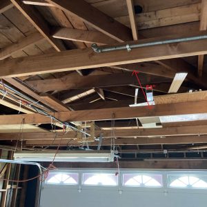

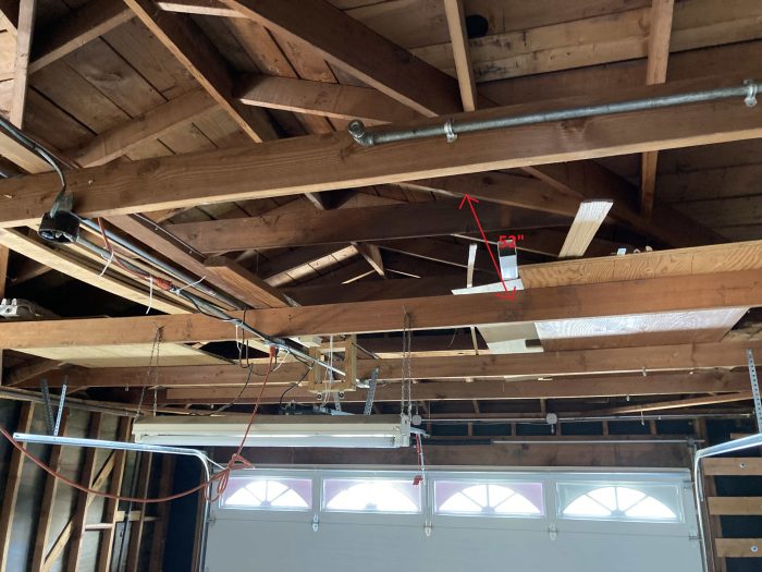

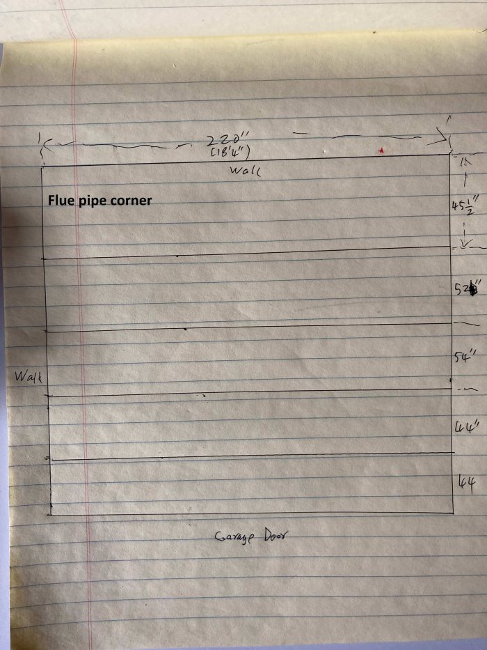

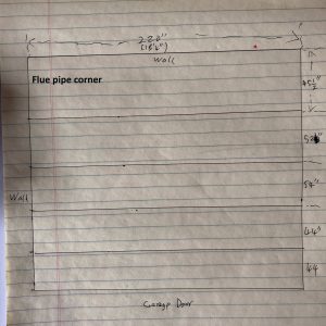

Garage wall to wall width: 18’4″
4 joists existing, 2x6x20, spacing around 50″.

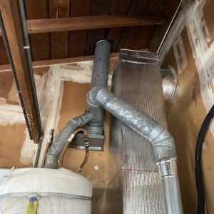

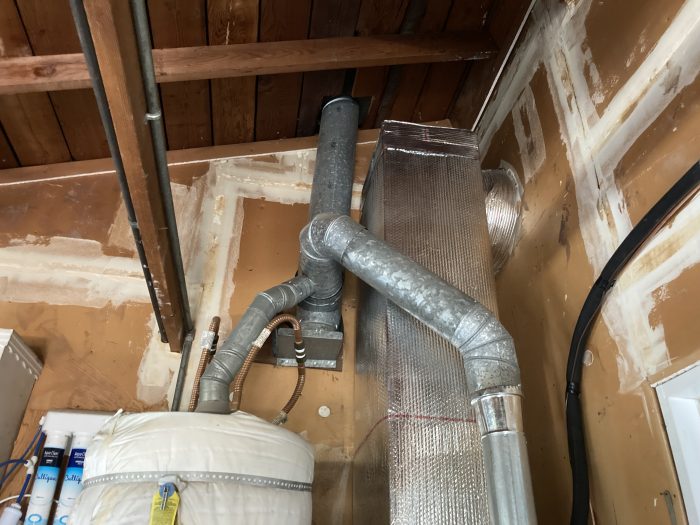

Furnace and water heater locate at north west corner, flue pipes join at joist height then go to the roof.

1. how do I add more ceiling joists to support drywall and fiberglass rolls? Comply with California code.
2. how do I ceiling the flue pipe corner?

    I would duplicate the framing that's there by splitting each 50" space into thirds, roughly 16" centers. Then I would strap across the framing with 1 X 4"s 16" oc.
