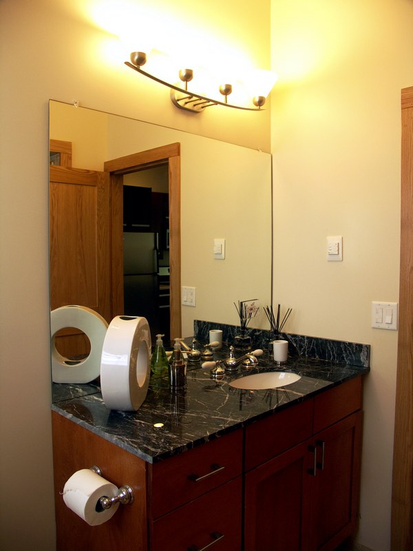

    I've cut granite counter tops with a masonary blade and a circular saw. Make a fence for the saw, and make sure you have two people to keep things straight. Put tape down and on the bottom of your saw.
    It wasn't a polished look, but it did the job. Here's the cut, the exposed end:
    1. TomC | Oct 05, 2007 04:25am | #4
      That looks like marble to me. I doubt that if you can cut granite with a masonry blade.
    2. FastEddie | Oct 05, 2007 04:54am | #6
      That's a nice soft marble top.  Pretty though.  What's that industrial roll of tp doing on the counter?"Put your creed in your deed."   Emerson
      1. CAGIV | Oct 05, 2007 04:56am | #8
        that's for REAL big poops...
        like after burrito night
