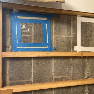

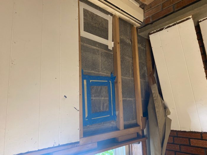

See pictures. The studs are 1.75″ thick covered with 70’s paneling. Half the basement that has exposed block has been painted with waterproofer or drylock. The side the previous owners finished with wall paneling is not, not sure why they did it this way.

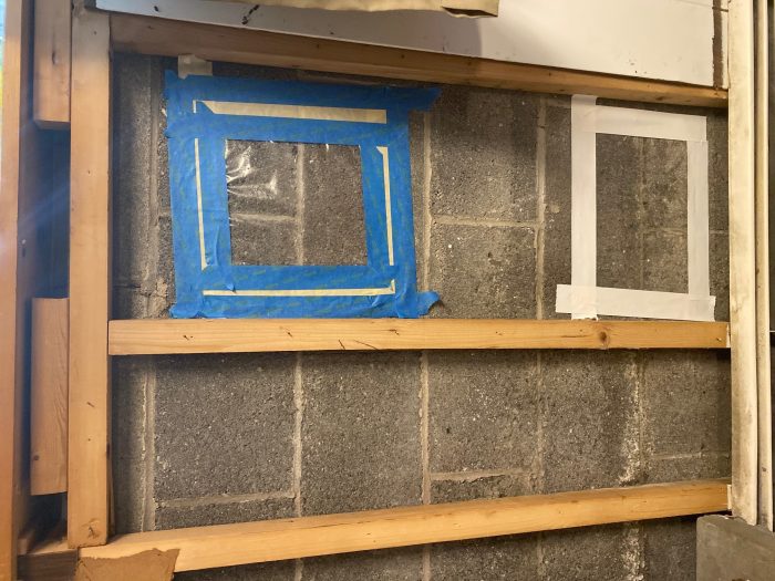

Anyway, I have been testing for moisture with the makeshift vapor barrier for the last two weeks on the exposed block and last night had the first sign of some condensation on the wall side of the plastic.
I would prefer to not have to disconnect baseboard heating if I don’t need to. Previous owners installed baseboard heating all the way around the perimeter of the basement level (4ft underground) raised ranch.
