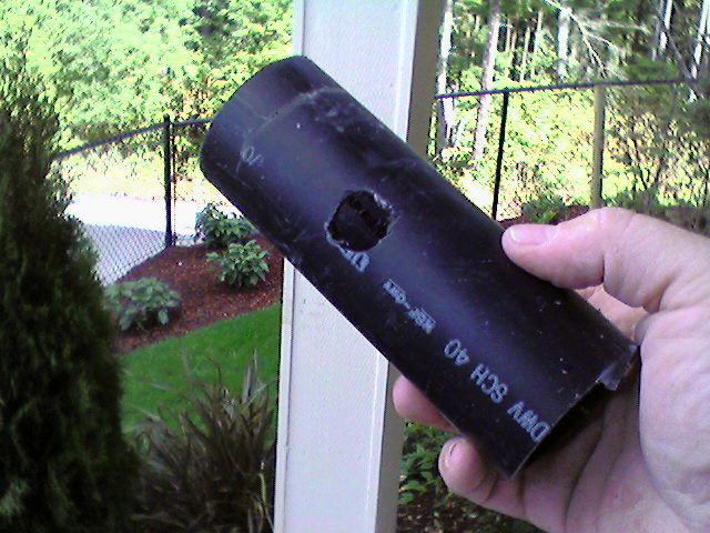

But here’s where it gets interesting. As I pull the padding and 6mil plastic in the kitchen and entryway, I find a huge puddle underneath on the concrete. I mean, not just damp, there’s enough water you could suck it up with a straw if you wanted to. Oh boy, where’s that coming from? I notify the building construction manager (the complex is 95% done, so they are still on site) and he looks and says “hmm. we’re gonna have to open that wall up.”
And they did. And found that the guys installing the microwave had drilled a 3/4″ hole right through the 2″ ABS drain line in that wall, and put their toggle bolt INTO the hole. Once the new tenants upstairs started using that line, the water would fall down the pipe, hit the toggle and splash/run out the hole and down the outside of the pipe.
So it’s hard to find fault with the microwave installers, but perhaps they were a little too eager with that 3/4″ drill? Or was it just an honest mistake?
Here’s a picture of the piece of pipe the plumber cut out.
So, I guess they should have used a different anchor? Maybe one of those epoxy jobs?
