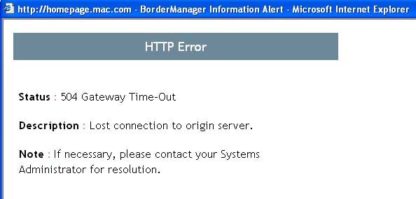

Hey, Cloud, the enlarged pics aren't coming up. What's up with that?jt8
"Most married couples, even though they love each other very much in theory, tend to view each other in practice as large teeming flaw colonies, the result being that they get on each other's nerves and regularly erupt into vicious emotional shouting matches over such issues as toaster settings." -- Dave Barry
Here's another set of pix... http://photos.itsa.info/The full-sized pix were showing for me. It's straight .Mac stuff which is Windows also. Don't know why they wouldn't be showing for you, nor what to do about it at the moment. I'll ponder it...
Here is the message I'm getting. Are you not hosting the pics on your own site?
OK... did you just fix something? Now they're coming up. Maybe a link somewhere along the line was down.

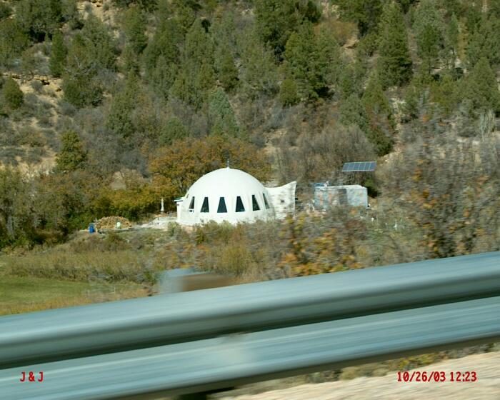

Joe H
Edited 9/28/2005 11:00 pm ET by JoeH
Was that shot taken anywhere near Roswell, New Mexico, Joe?
Jim, missed this post long ago.
That is on Hwy 89 in Southern Utah. Been awhile, I think all the aliens were removed and dissected long ago.
No sign of the mother ship either.
